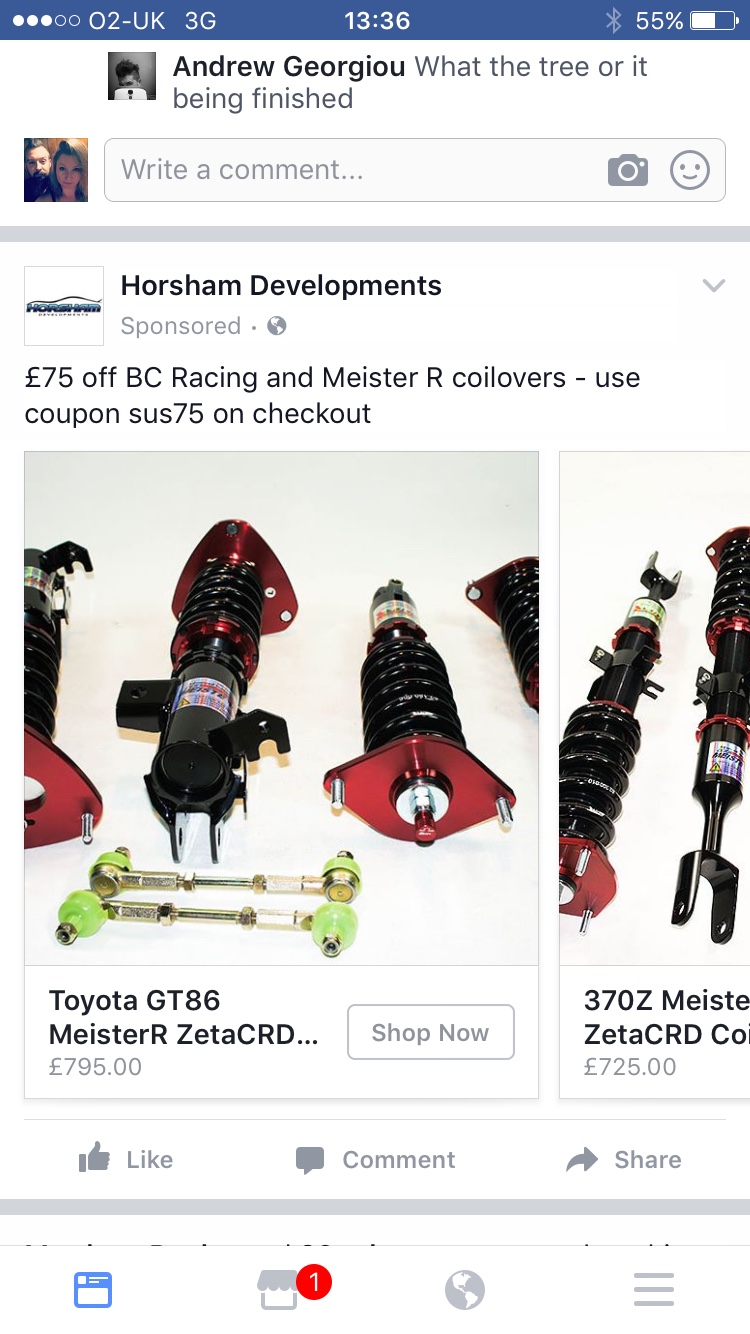

Horsham are offering £75 off meister and bc atm
