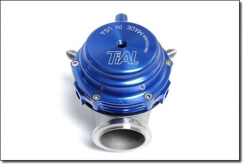

This is exactly the same set up i'm going for, just about to order my Maxworx manifold (will have a Swain Tech ceramic coating as well), already have the Tial V band exhaust housing and Tial MV-R wastegate (44mm) , next job is to sent to Turbodynamics for a brass bearing upgrade, Tial exhaust housing install and Zircotec coating on comp/exh housings. This set up though is well expensive in the end (all pipework, external gate, new turbo lines, manifold, exhaust housing etc etc) but no one said power was cheap :), also I need to find the best way of keeping my internal wastegate shut as will be running the external....

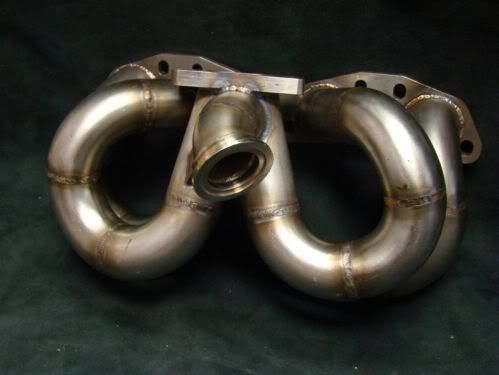

Mazworx Manifold (specifialy with GT28 V Band turbo connection which isn't the one show)

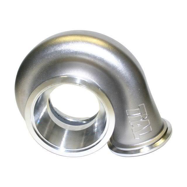

Tial GT28 V Band Exhaust Housing

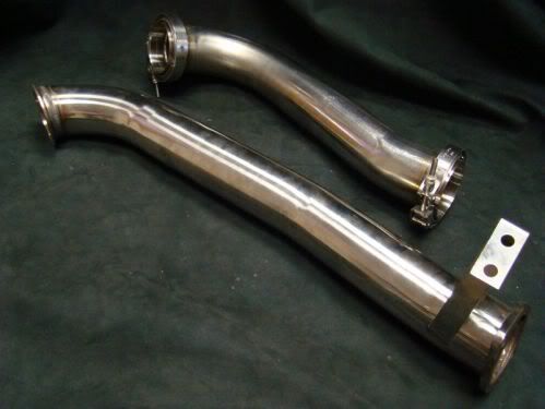

Mazworx Downpipes (specificaly for this manifold)

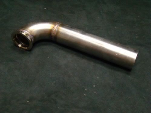

Mazworx Wastegate Dump pipe

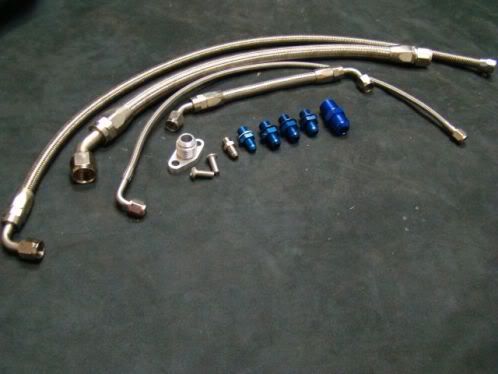

Mazworx Top Mount Turbo fluid lines
Tial MR-V 44mm Wastegate

what a/r for the vband housing? Appears to be two options. 0.64 or 0.86?

Tial Sport offer 3 a/r options for the housing (but I only know of the 064/0.86 that you mentioned also, may be also a 1.0x ?), I think he was using the 0.64. Sorry the mod commnet was confusing, mod in the sense that you need to remove the existing housing and fit the Tial one.
