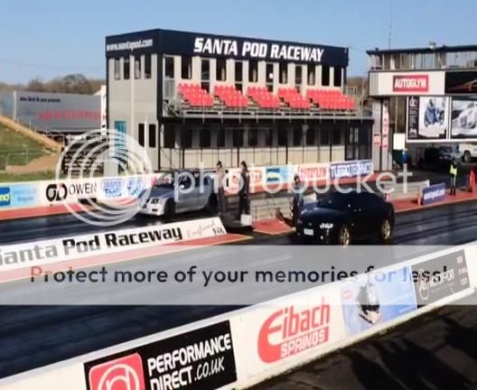

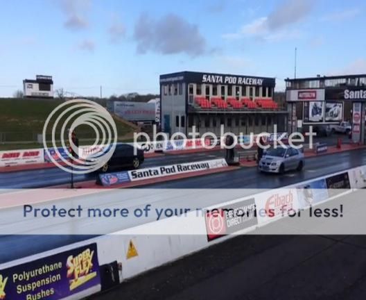

Well, went to Santa Pod and ruined the clutch, lol. I got a mate to take a video. You can hear me struggling getting into 3rd big time with the prolonged break off full throttle here
the clutch slipped big time on the next run, I initially thought it was wheel spin as the car normally breaks traction in 2nd in the dry...
A new ACT heavy duty paddle clutch rated to 650ft lbs has been fitted with a brand new lightened flywheel but I've got to bed it in, so no heavy use yet. This seems to be the last part of the puzzle before I sell up, everything is new but I've got my eye on something else. It almost seems a waste!
