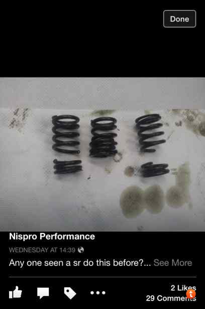

I wouldn't be that surprised ,I saw a picture the other day where a full set of oem springs had snapped clean in half!
Apparently age related failure happens quite commonly on sr's more often than not when people upgrade their cams
