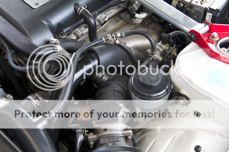

Hi guys,
I have recently got an S15 and it's boosting above stock. I had it on a dyno yesterday and it showed about 1.1bar (17psi).
There is no boost controller on the car so I'm trying to find out how the boost has been turned up. The guy at RDT said he didn't know the S15 engine perfectly and wasn't sure if the actuator hoses were right?
Can you have a look at this photo and see if everything is as it should be. If it all looks ok can you suggest ways the boost has been increased?
Here's the full engine bay in case you need to see it

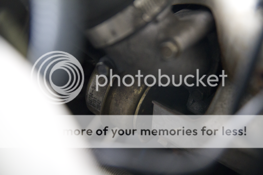

I've also got a photo of what I think is the actuator. Someone on SXOC said the car might have an adjustable one. I know **** all though so I'm just providing as many photos and as much explanation as I can!

i think you got a mechanical boost controller in the engine bay on the right hand side of that last photo...

i think someones been playing about with the wastegate under the exhaust heat shield, looks like your missing the bolts that holds the heat shield in place in the pic

As said above, you may have a manual boost controller (can't quite see in the picture) or an adjustable actuator. If your actuator has a thread on it then it's an aftermarket one, if you post up a picture of it will be easy to tell
Someone on SXOC suggested that as well actually, although they said its a standard actuator. Here's the only photo I can get at the moment.

Ok, looking at those photos I can't see a mechanical boost Contoller Tee fitted in the boost lines.
The 2 things that could cause your boost spike are if the boost solenoid hose restrictor has been removed or the actuator (it is the stock one) is sticking stopping the waste gate opening.
One other thing I would do is cable tie those plugs, one is for your O2 sensor, to the loom behind the ABS unit. It tidies it up and gets them away from the heat sheild.

Looking at your engine bay there is nothing changed, that actuator is the stock one and all the standard hoses for the OEM boost controller are in tact.

The solenoid restrictor hasn't been removed, you can see the silver rings on the pipes that go to the T piece. They are the Restrictors inside.
The waste gate latch could be very stiff or stuck on something but it's unusual it holds a steady 1.1 bar though.. If the gate was jamming the boost could keep climbing. Take the actuator off and see how easy it is to move the wastegate arm, it should move freely.
Edit: it could also be the standard solenoid malfunctioning, to test this simply run a piece of 6mm
hose from the actuator to the intercooler pipe, this will take the oem controller and t piece etc out of the loop and mean you should be running just actuator pressure of 0.6/0.7 bar. Try that first, easy to do.

the guy you took the car to should have tested you actuator..................... simple really,, get a hose one end on the actuator one end on the compressor (with a gauge) then pressurize it, you will only be able to go upto a certain pressure, and then the actuator will open, here from the nissan hand book itself.."
WASTEGATE VALVE ACTUATOR
NMEM0050S06
Apply compressed air to wastegate valve actuator and check it for
smooth movement.
I Do not applying compressed air to the actuator continuously.
I The air pressure should be in the range of 38.7 to 44.0 kPa
(290 to 330 mmHg, 11.42 to 12.99 inHg).
