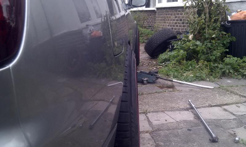

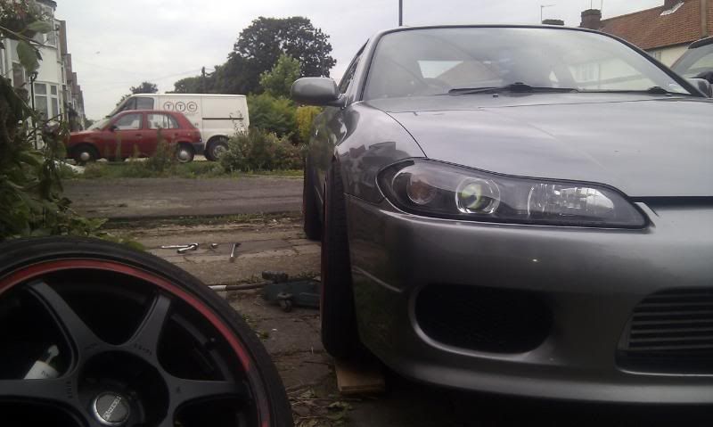

This was the result of my 9.5j et 12 rotas with a 225 wide tyre. I sold them a week later.

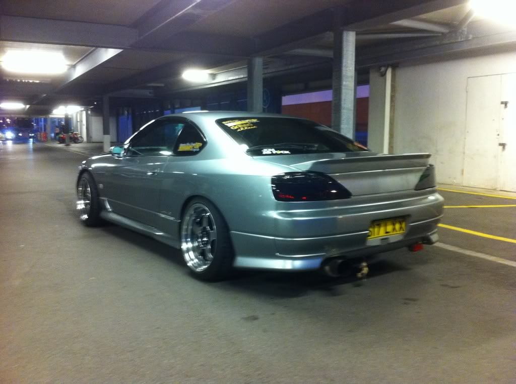

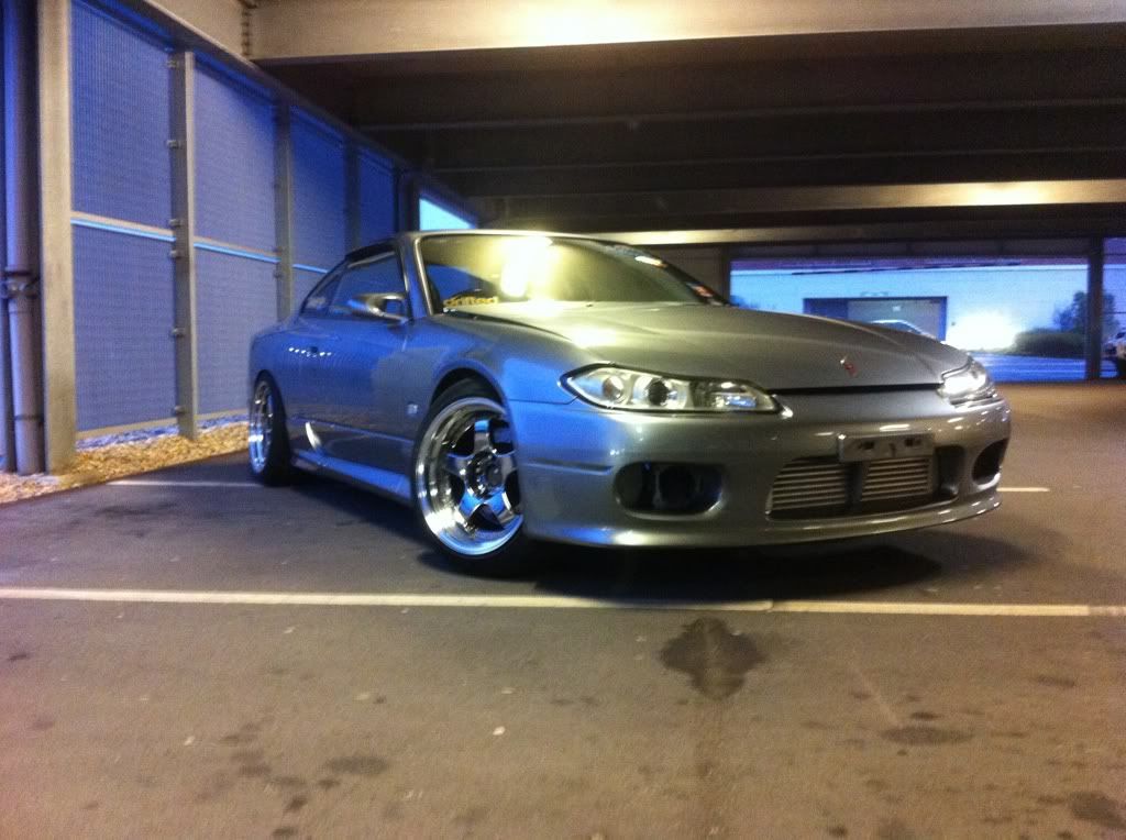

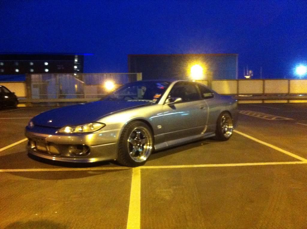

They fit fine on mine 9.5j et12 allround 225 stretch on the front no arch roll or camber. Rears rolled and Cambered with 235 stretch
29 October 2010
272
Dorset
Here's some pics wheels are SSR professors

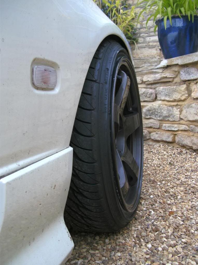

Im running 17x9.5 up front. Effective offset is et+10. -2.5 degrees camber. Federal 595, 215/40. Even like that, theres huge amounts of grip :)
