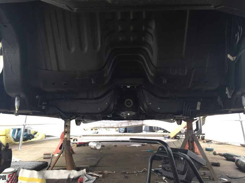

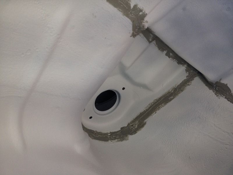

Undersealing Continued:

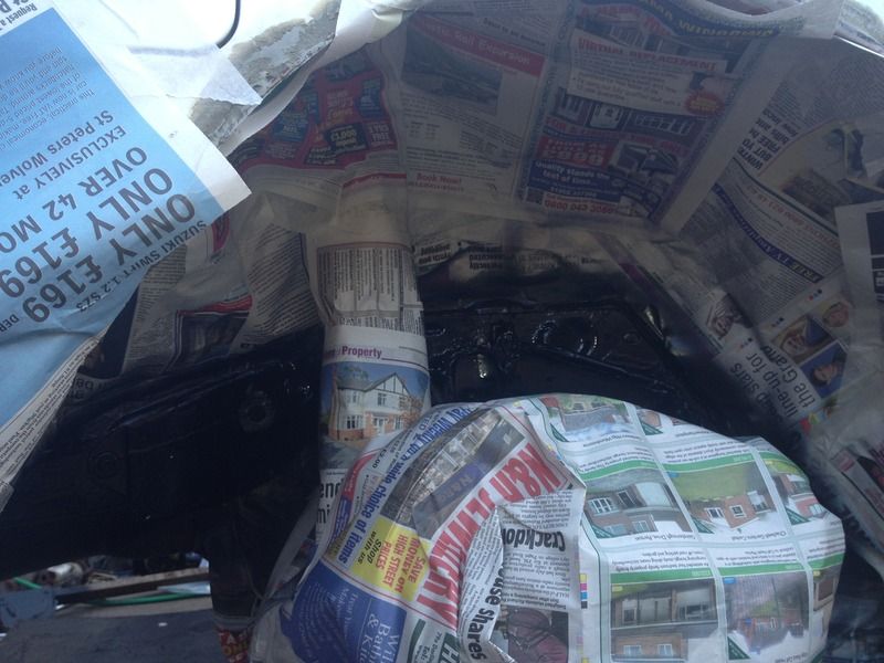

Fully cleaned the arches and underbody to prepare for application of Bilt Hamber Products:
Applied Zinc Primer and Underseal, and finished the arches in White Stone Guard :cool: Painted some brackets and fitted new bolts
& Fitted the new DRIFTWORKS CS2's

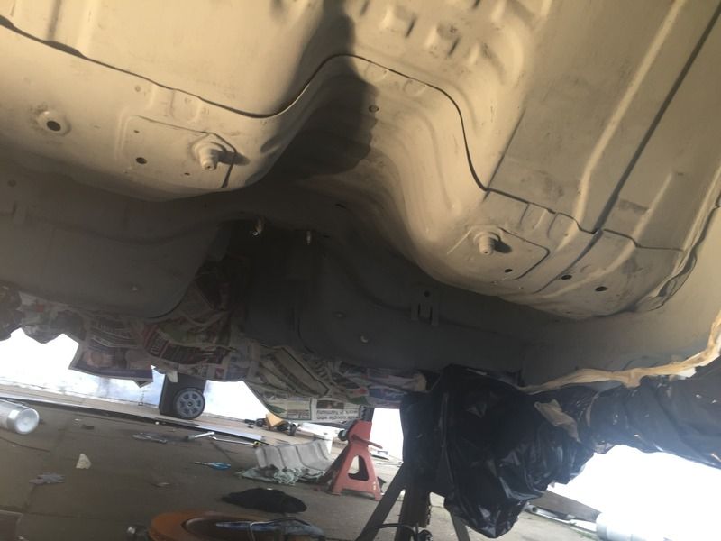

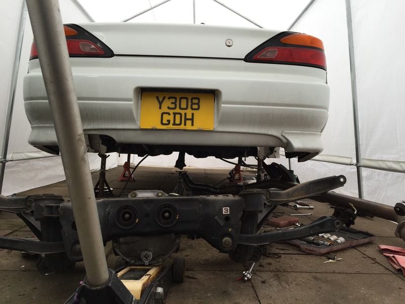

Now that the front was all sorted, i moved to the rear

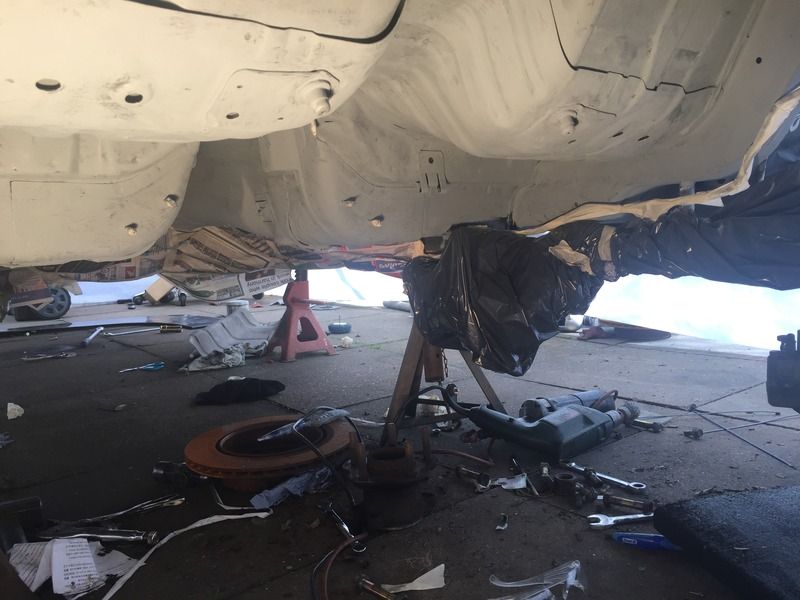

First place to start - Drop the subframe & petrol tank
Next was to jet wash to remove all dirt and leave to dry
Then it was Zinc Primer time again!

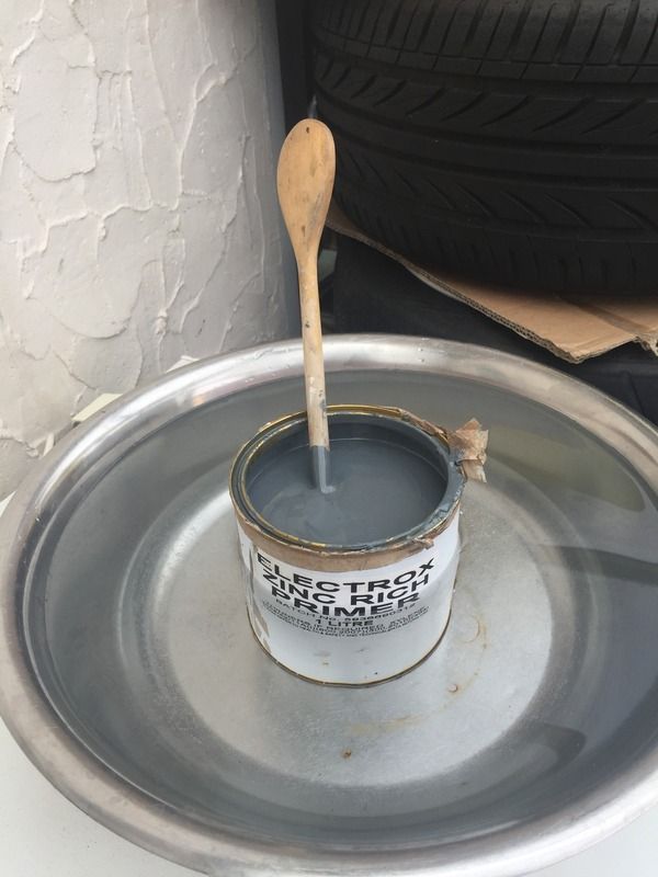

WHIPPIN THE BILT HAMBER - note the bowl of warm water, it was so cold outside the Primer was so gloopy lol. Sitting in the warm bowl of water sorted it right out and made applying it much easier.

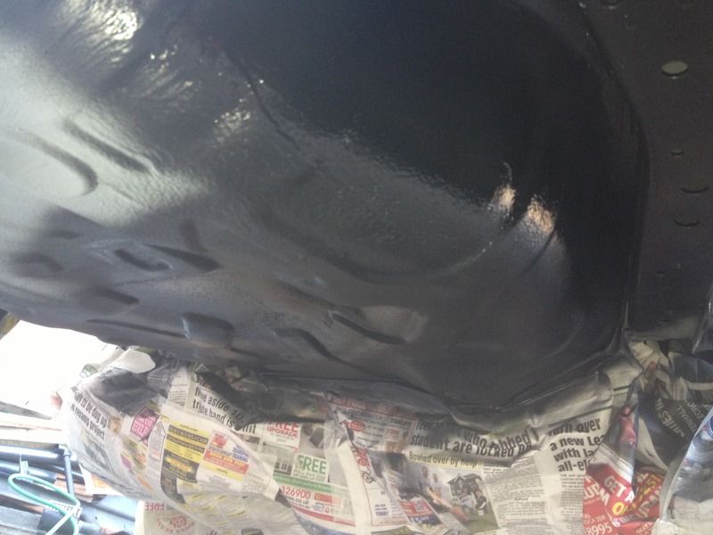

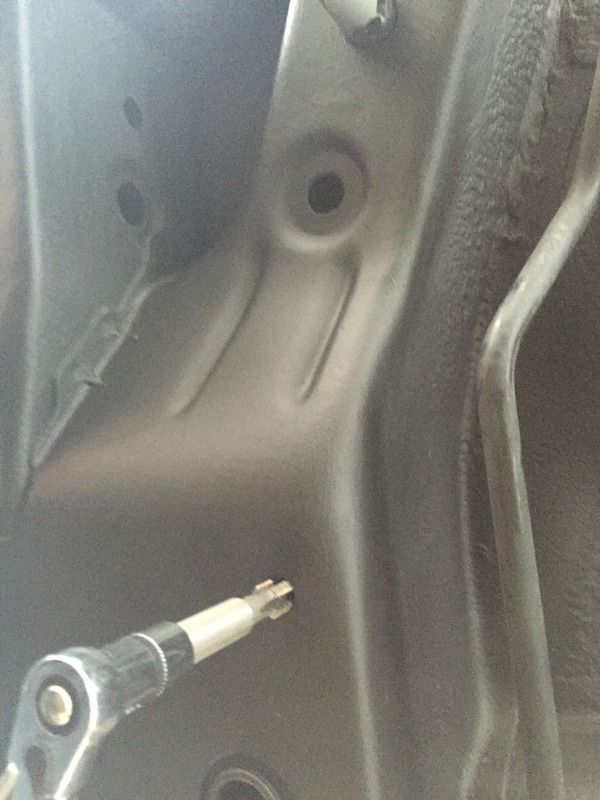

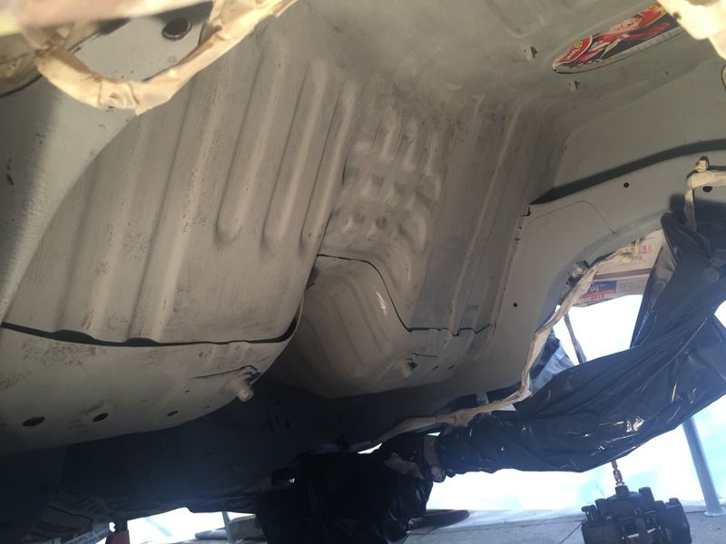

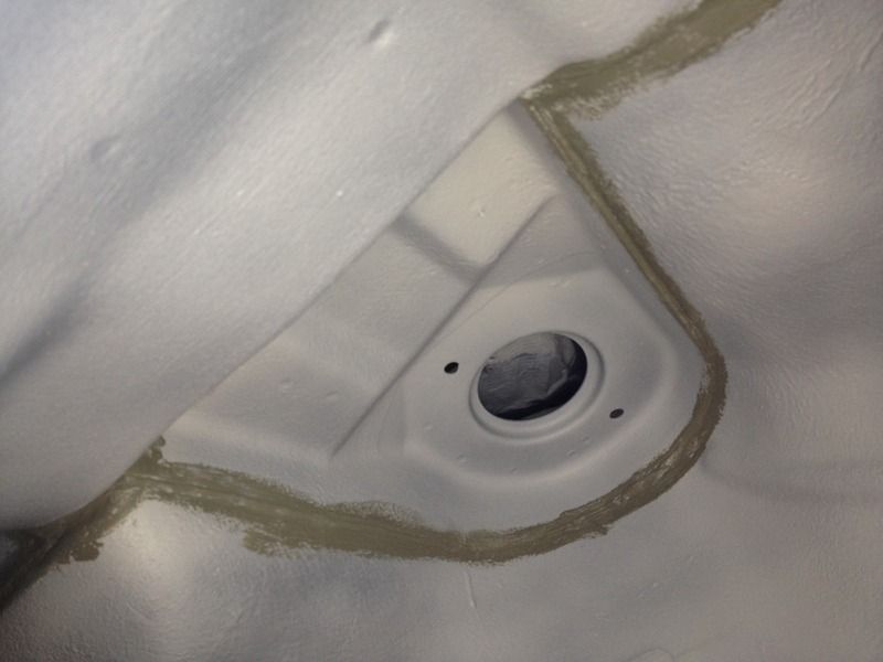

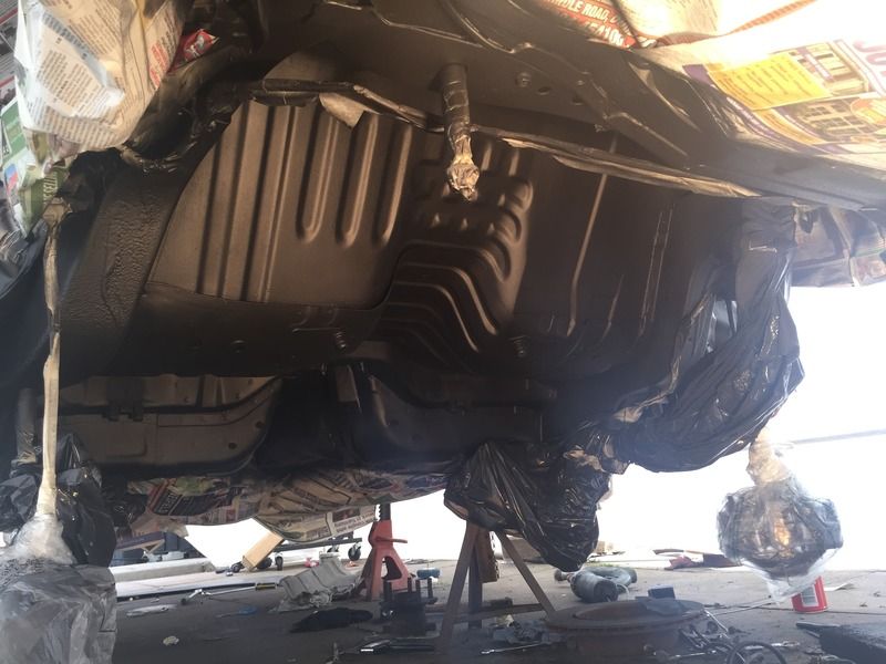

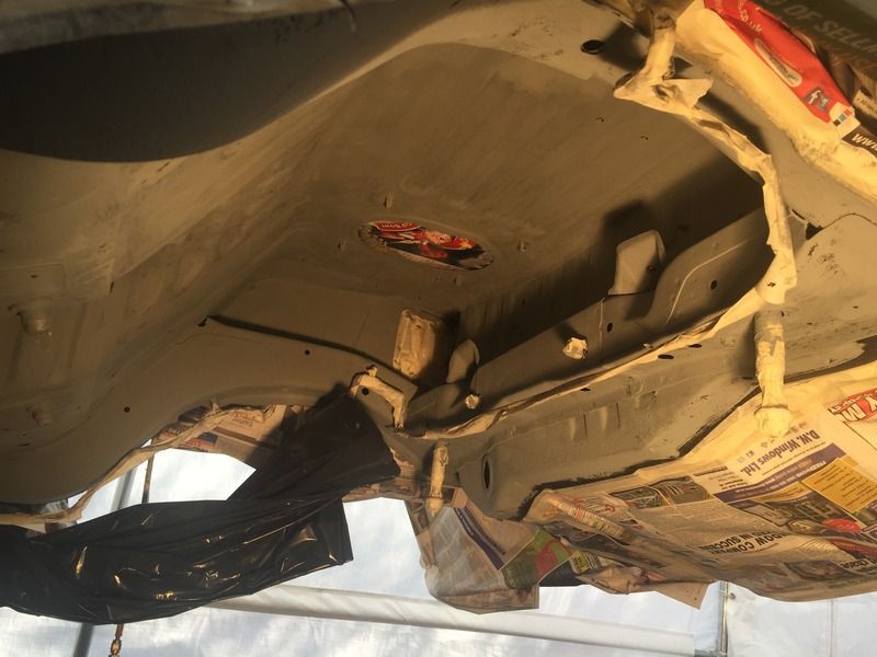

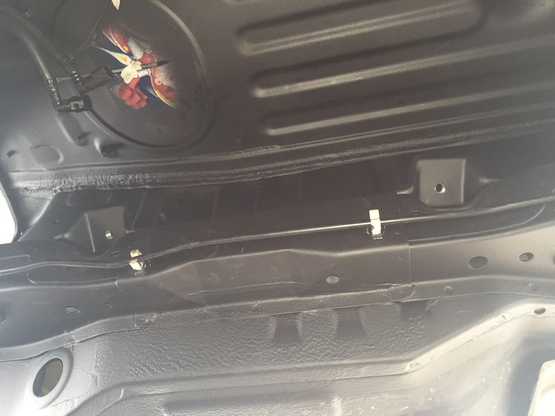

Now all surfaces, and nooks and crannies were Zinc covered, i left it to dry thoroughly - then applied the the good stuff
Tap set out and cleaned all threads

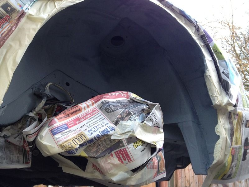

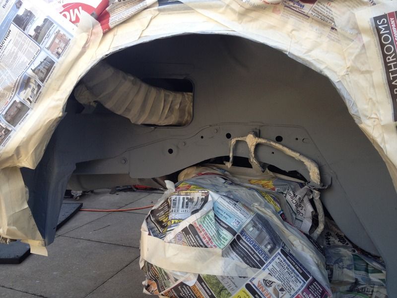

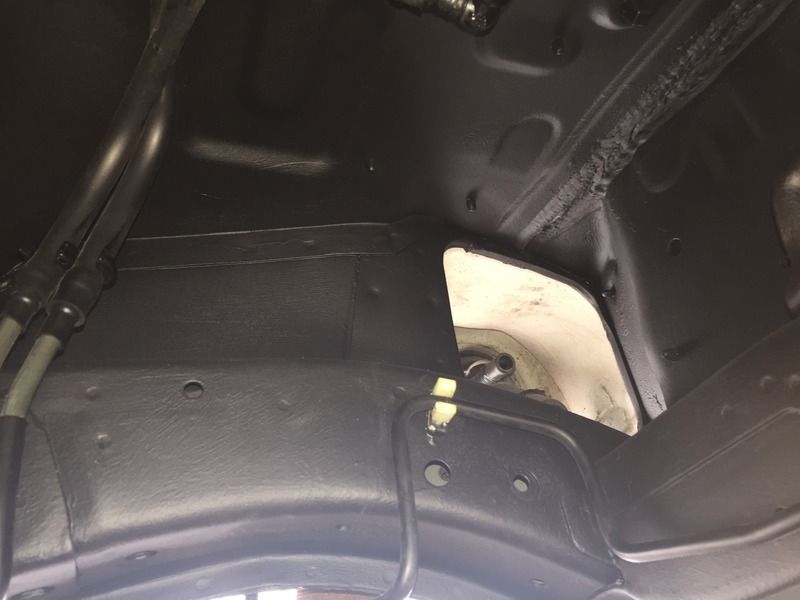

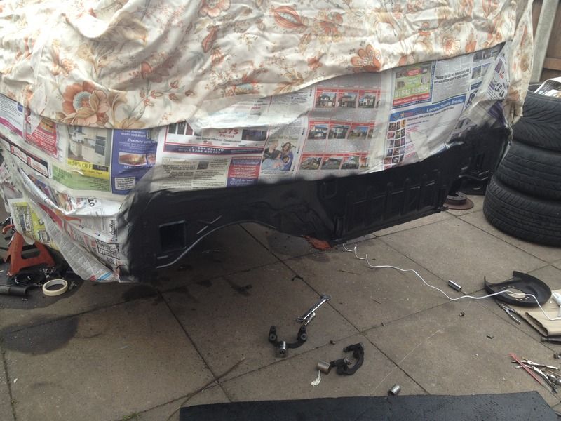

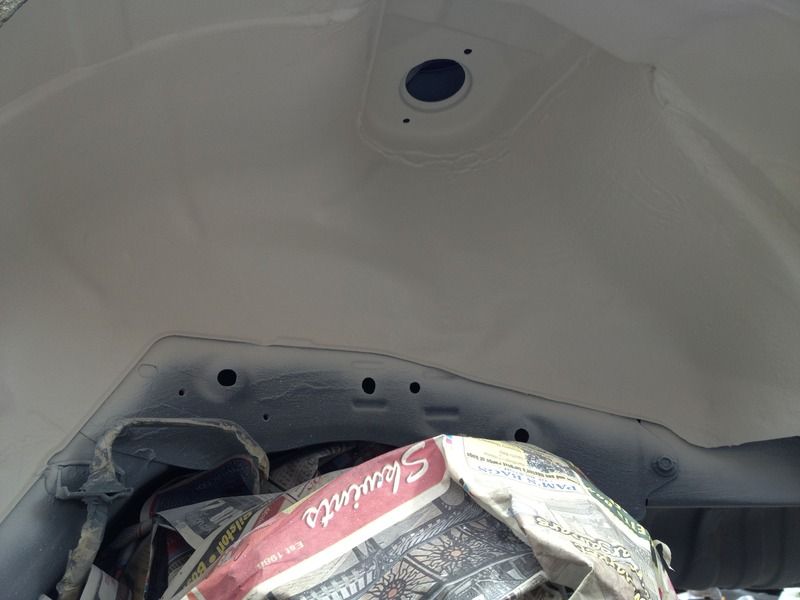

Now for the rear arches, again Zinc coated - and seam sealer on all joins

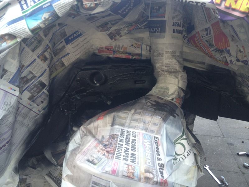

Then white top coat, but the lower half/chassis rails i wanted to blend in with the chassis, so i did it in two stages
First apply the white - let dry, then mask off and apply the black

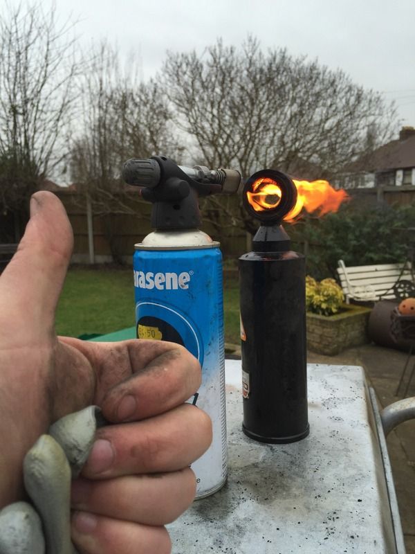

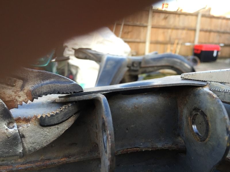

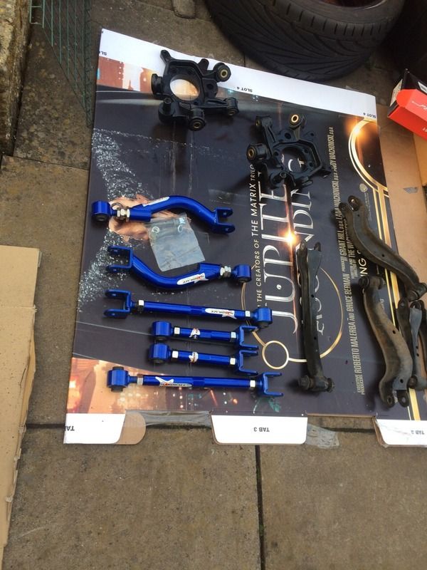

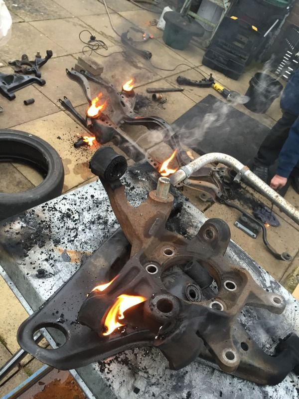

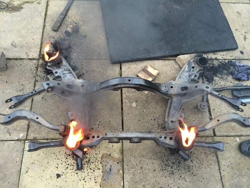

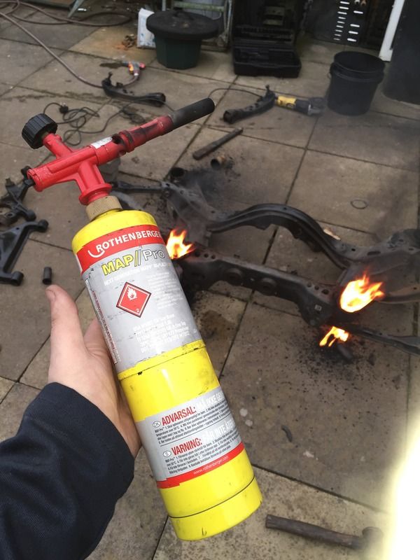

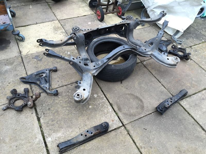

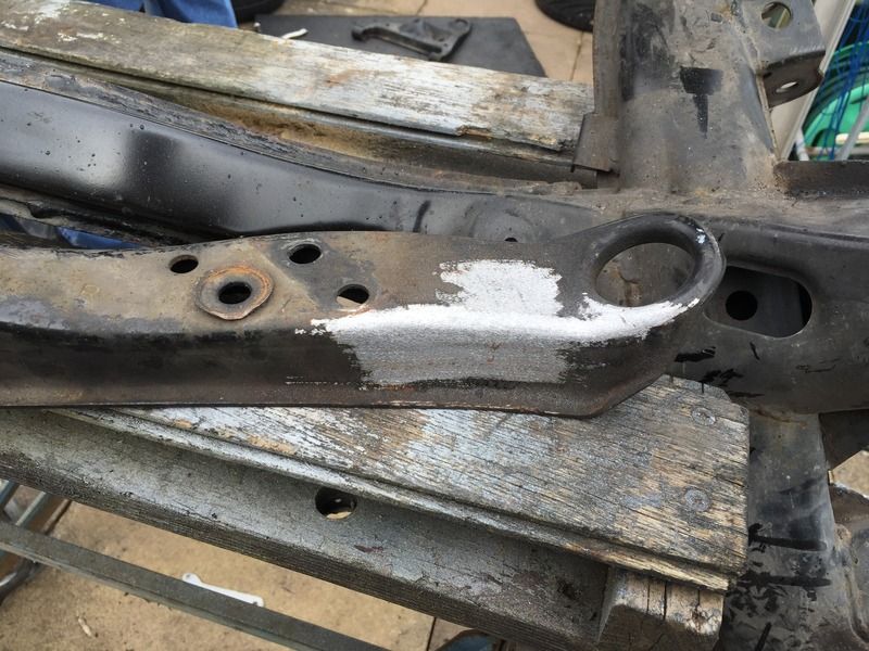

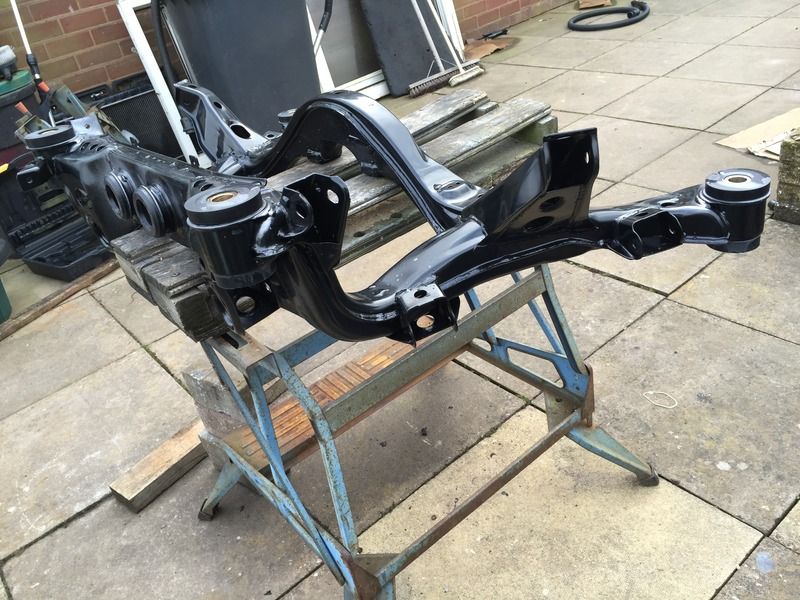

So next up was to address the subframe, hubs, arms & coilover cups. Full Energy Suspension Graphite Impregnated Bush set to be fitted, so time to get the blowtorch out!
Ready to fit all of this:

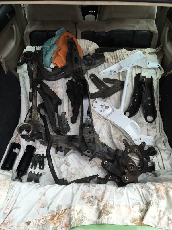

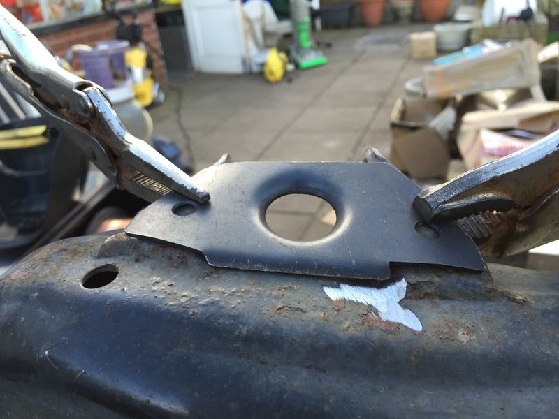

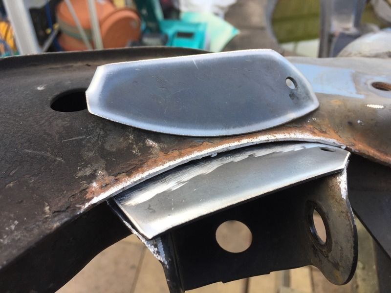

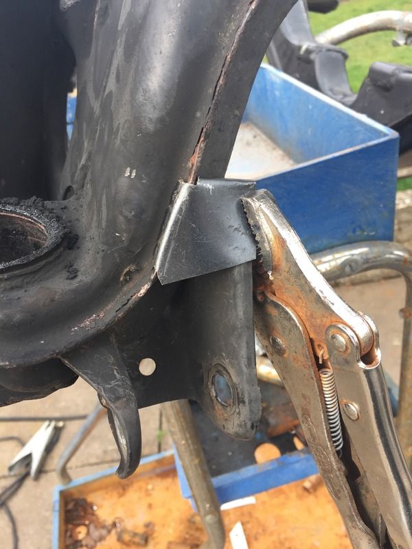

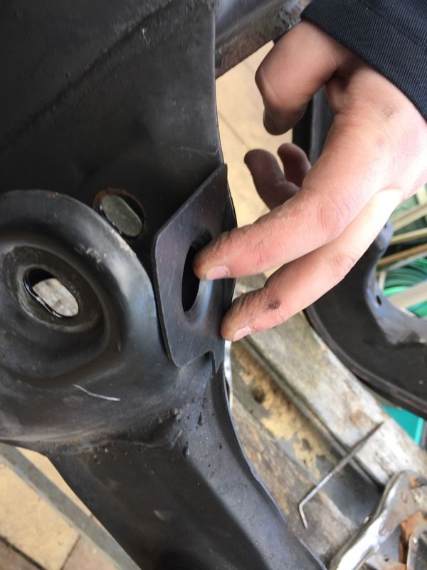

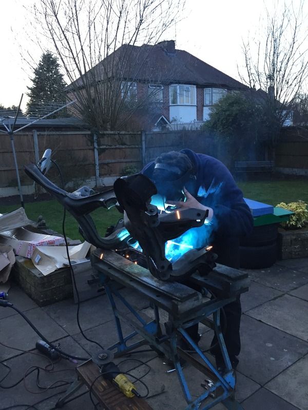

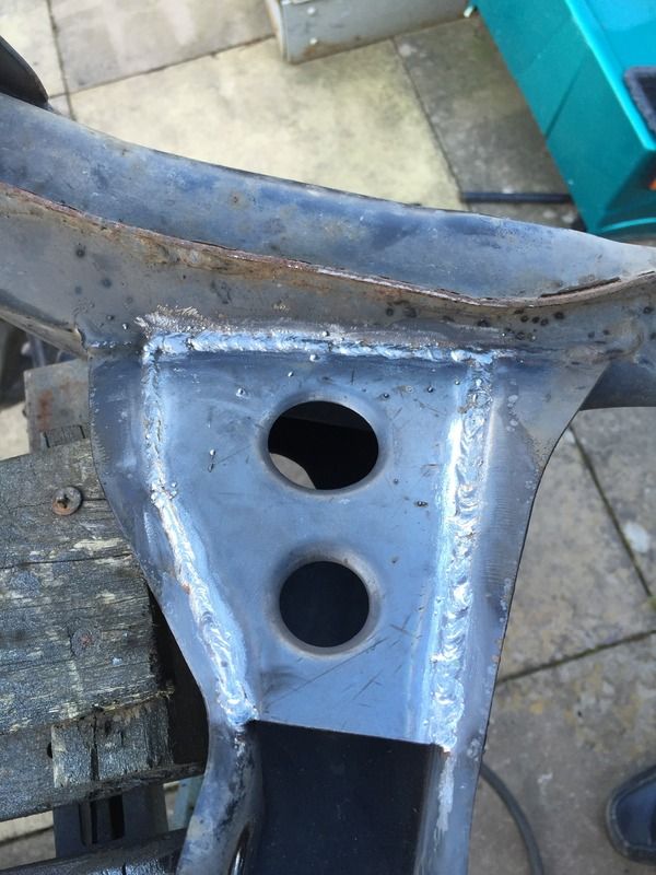

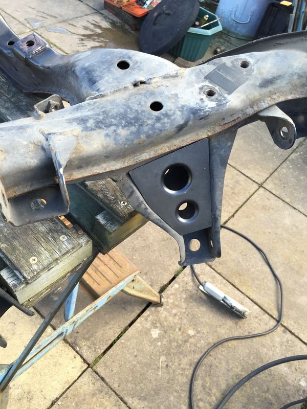

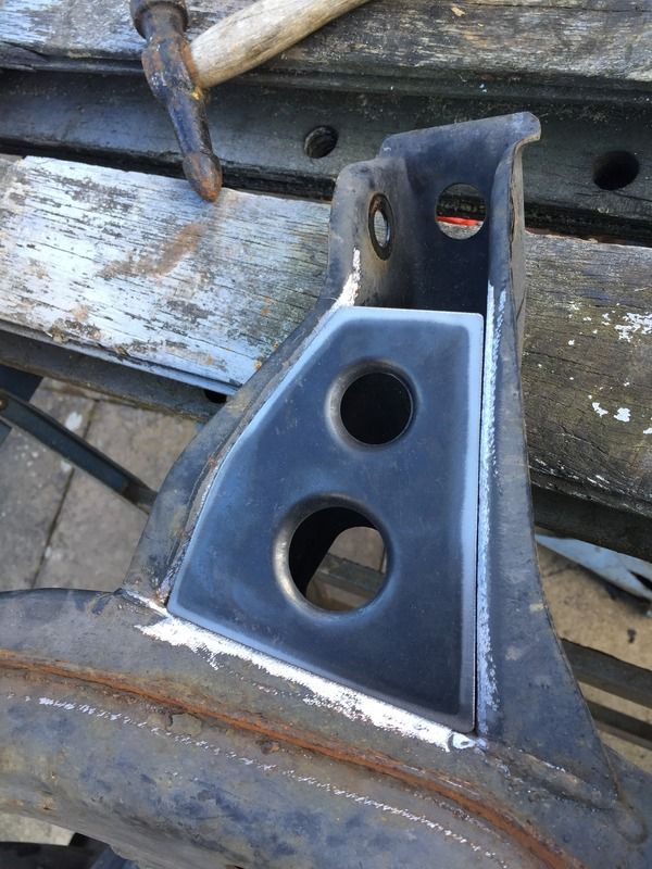

Next up was to fit a GKTECH Subframe Reinforcement Kit
Weld Time
Also removed lock stops on the front arms for future locks mods

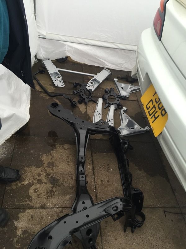

18 September 2011
726
West Midlands, England

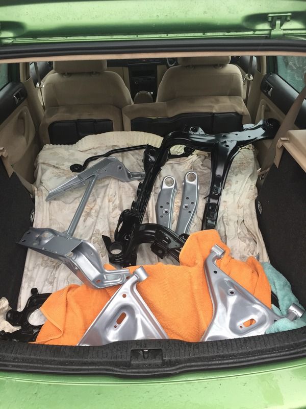

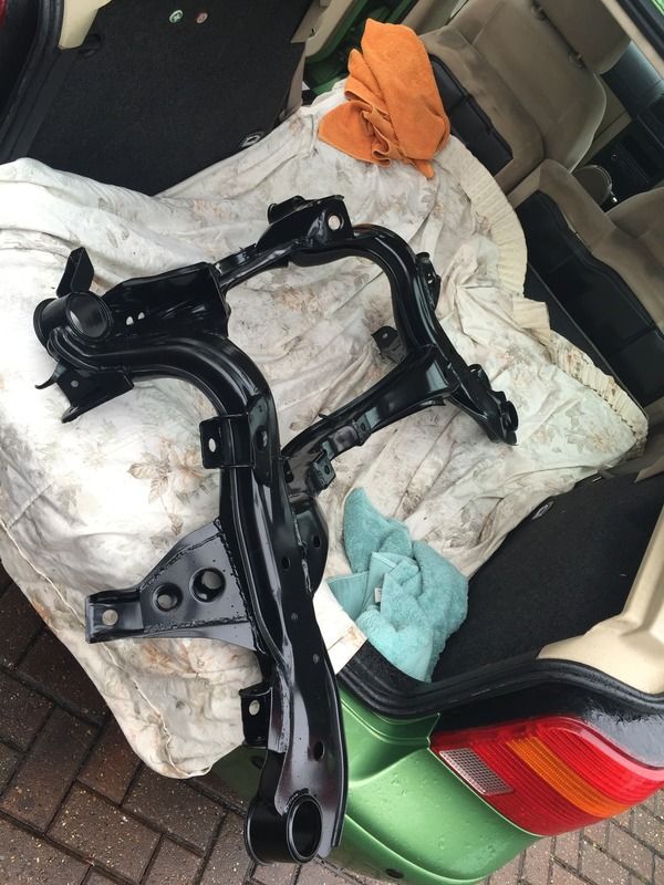

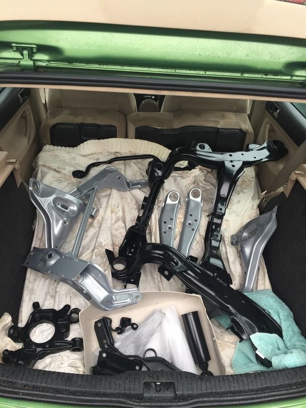

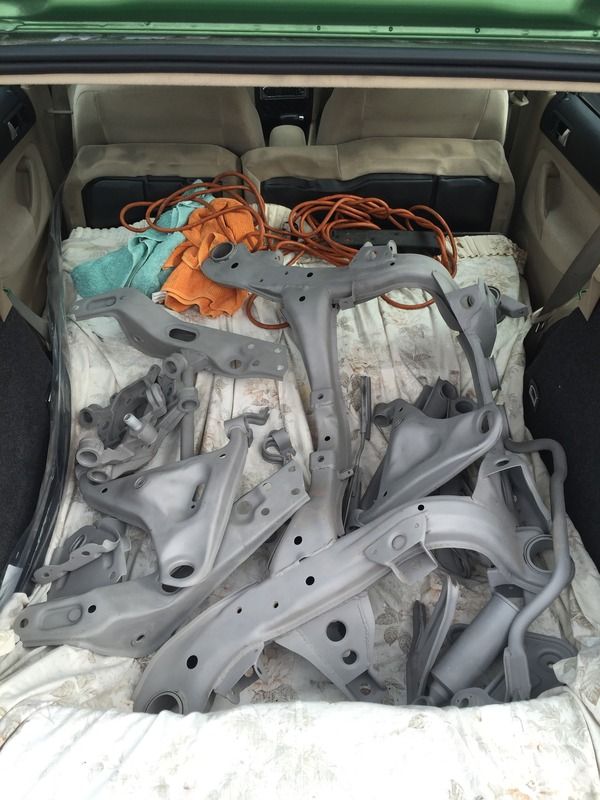

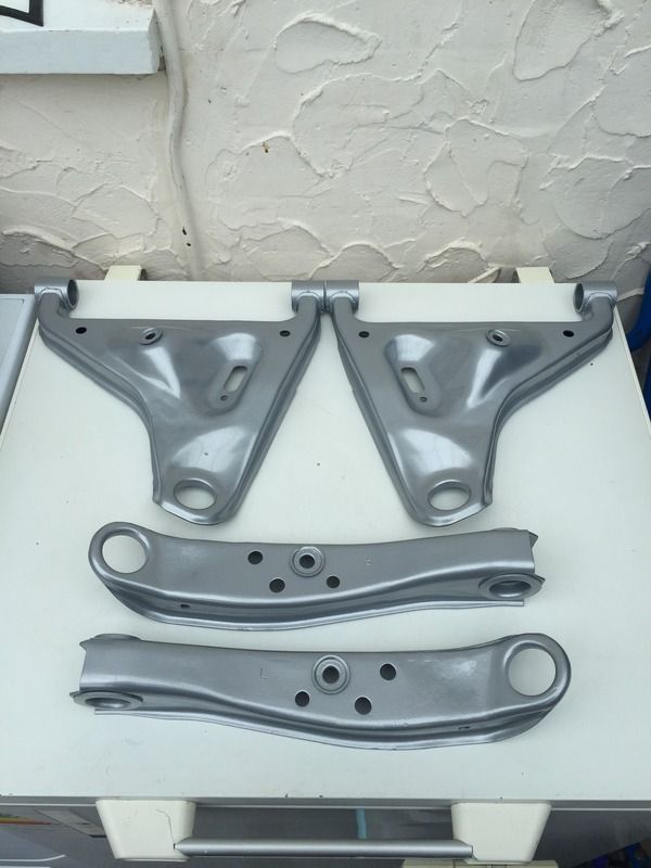

All loaded up for shotblasting at Applied Surface Treatments
All done
Next up was Powdercoating at Protech
Oem gloss black Black & Nismo Silver

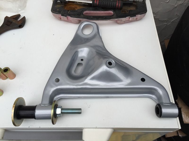

Energy Suspension Bush install & MOOG ball Joint Install
Bushes installed on Hubs

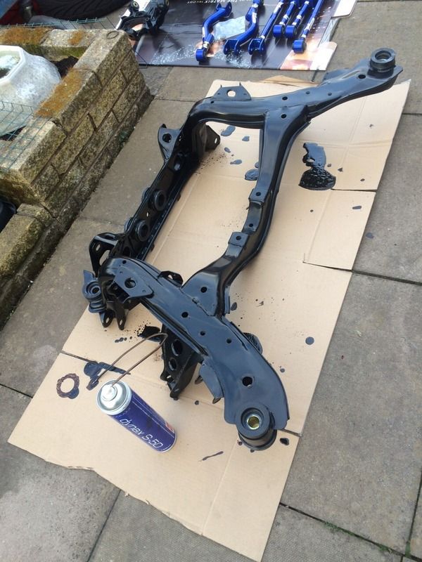

Then pumped the box sections of the subframe full of Dynax Wax Oil - This thing will NEVER rust haha

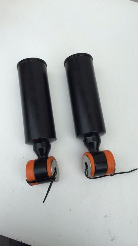

Driftwork CS2 rear cups got nice new uprated Bushes

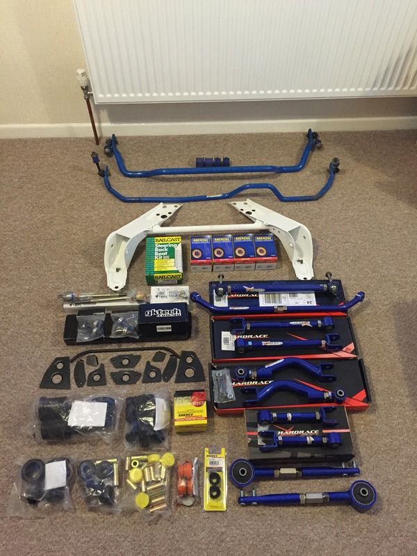

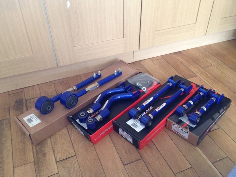

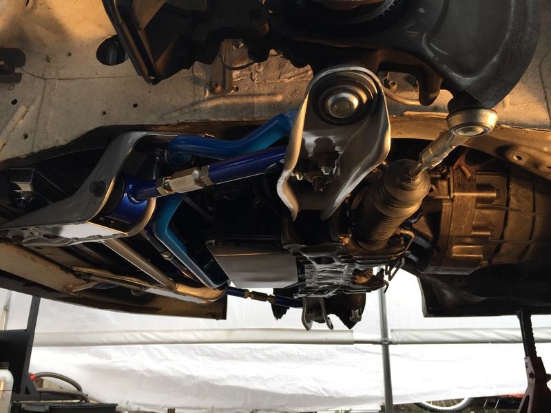

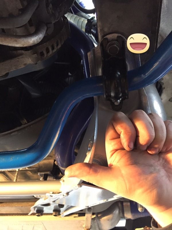

Next was to fit:

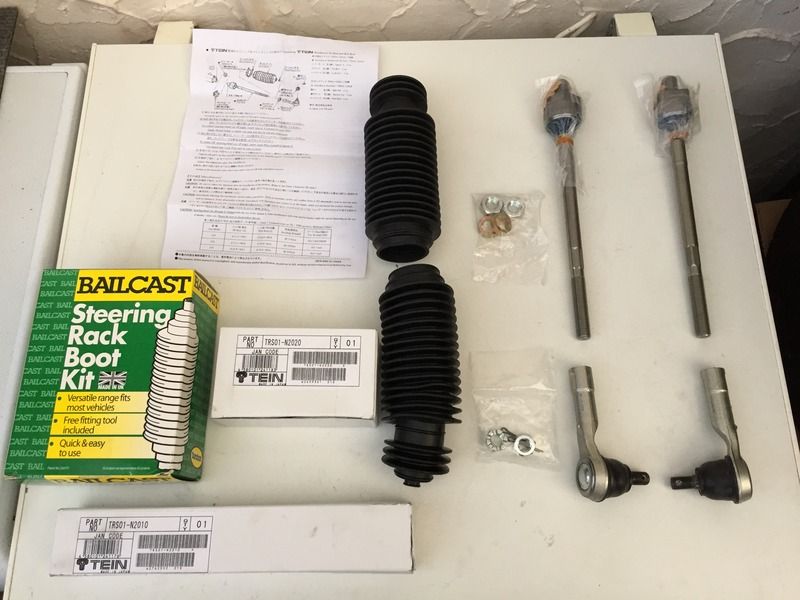

- Tein Extended Track rods & Track rod ends, with Extended Rubber Boots
- Nismo Power Brace

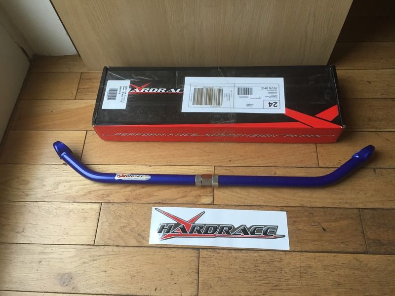

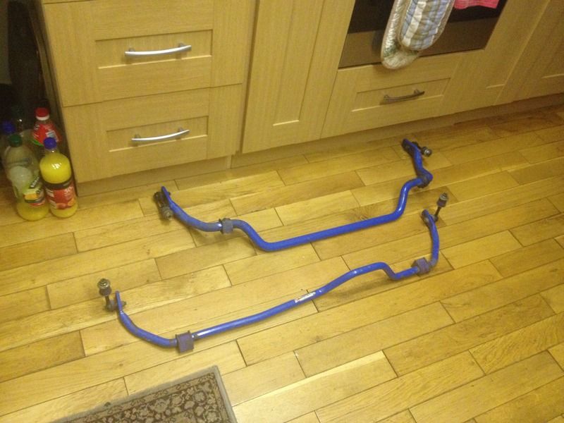

- Hardrace ARB with Hardrace Drop Links
- Hardrace Tension Rods
- Energy Steering Rack Bushes
- Refurbished Lower Arms with Energy Bushes & MOOG Ball Joints

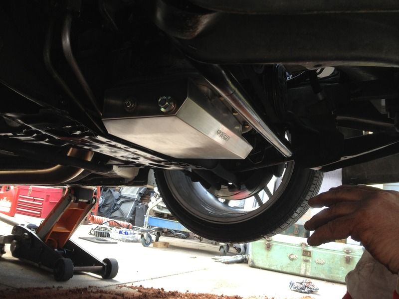

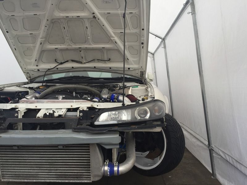

Nice amount of extra lock

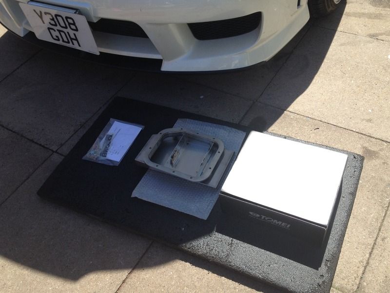

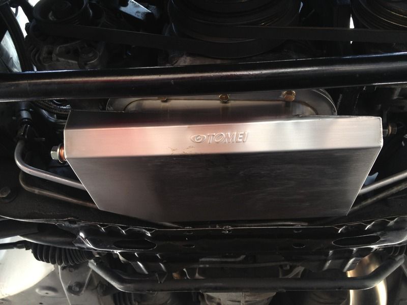

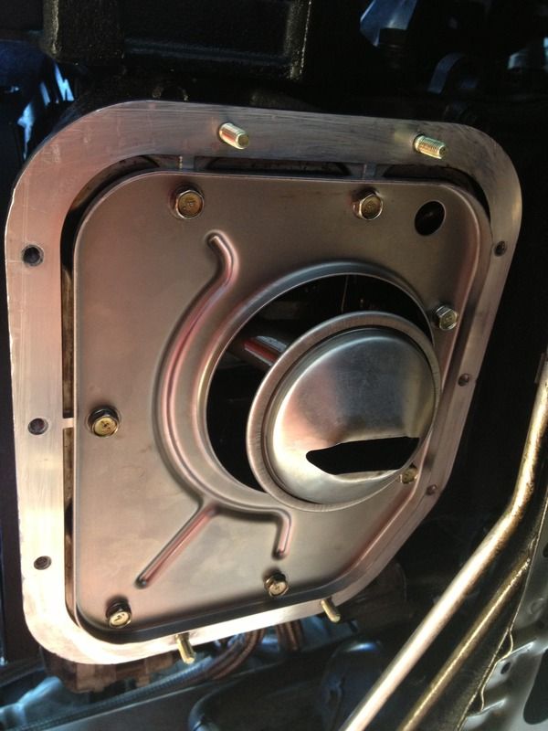

As you can see in the picture above, i also installed a Tomei Extended and hinge baffled Sump/Oil Pan
