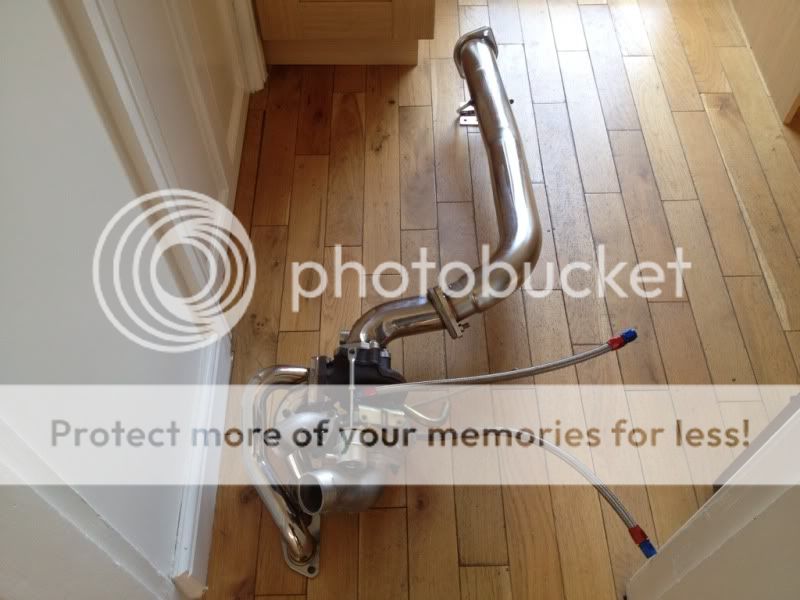

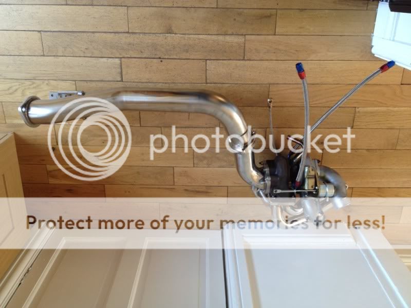

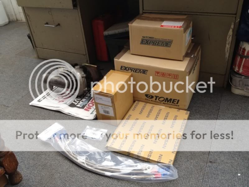

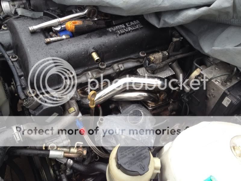

Tomei Manifold, Tomei Elbow, Blitz Downpipe, OEM gasket set, HKS Actuator & Braided Lines fitted
The T28 is like new - ZERO shaft play.

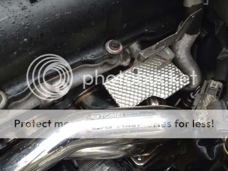

Also lined the mount for the Wiring connectors with Heat Shield Metal

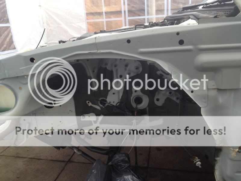

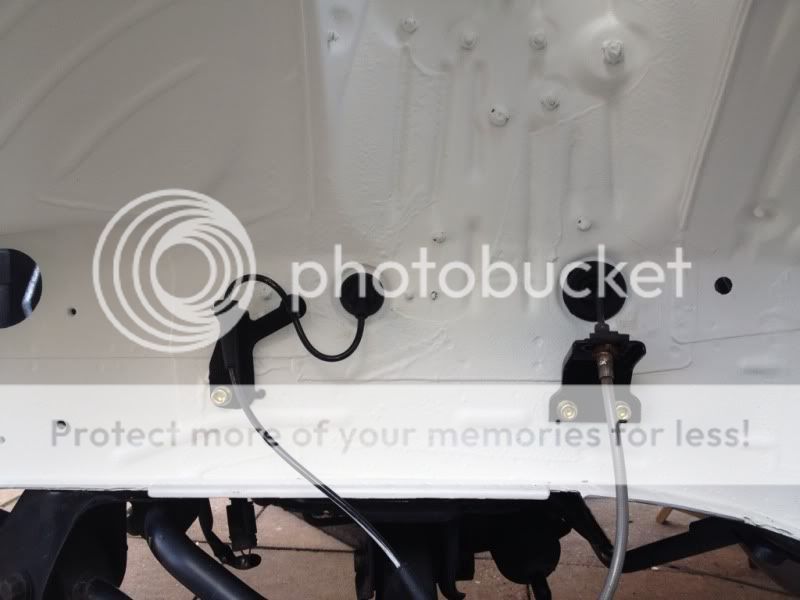

ALSO, the most time consuming job EVER - Arch and Underbody underseal nearly complete. Just the rear boot floor underside left to top coat in black stone guard.
Cleaned every inch
Applied Zinc Primer and Underseal, and finished the arches in White Stone Guard :cool: Painted some brackets and fitted new bolts

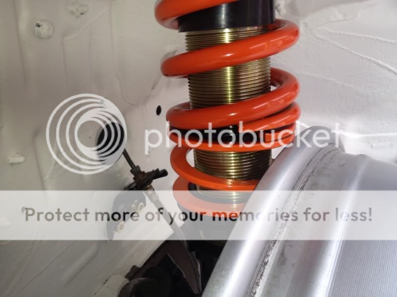

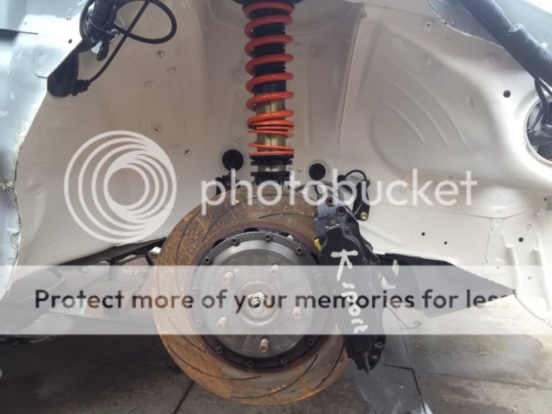

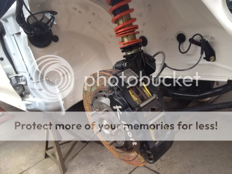

& Fitted the new DRIFTWORKS CS2's

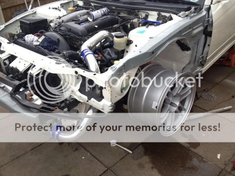

Test fitted the 10j's
DENIED
Unsurprisingly they need spacing out a little.

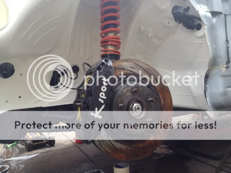

I will do a proper update soon, still a huge amount to do before the Nurburgring in May! A whole week off now to get her back on the road - Z32 rear brake conversion here i come, wish me luck :rolleyes:

Dude! Cheers for the update that looks awesome! Whack those 5mm slip-ons I gave you and they won't scrub.
