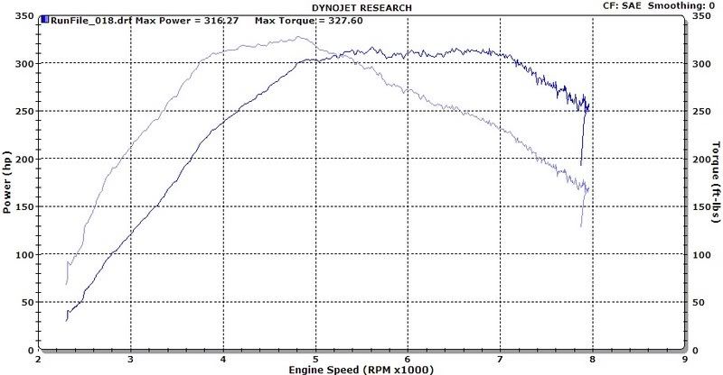

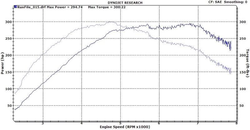

Yeah, properly set-up the stock T28 is awesome.
We did 316hp with 327tq at the wheels on my car.
turned it down a bit for the road course (heat) but on the street it was great

Spent quite a bit of time researching the best set-up to maximise Tq and responce.
So my tuner, Aki Fuchigami from Garage Bomber and his good friend Haiyashi san from Garage Saurus put together the tuning map for my car.
Since i mostly use the car for circut/hotlaping. The above tune was a big aggressive for the track as it brought my oil/water temps quite quick (stock rad/no oil cooler at the time ) It was fine on the street but i wanted a bulletproof set-up at the track so we turned it down a bit.
Here's a dyno of the map i run at the track,:

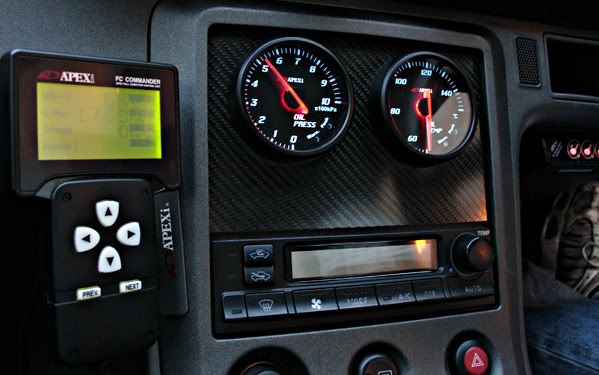

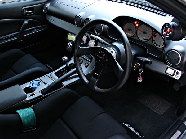

Update: Apex'i Gauges added :thumbs:

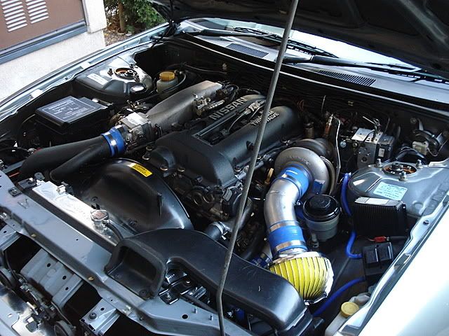

Hey fella's,
it's been a while, I'm a bit over due for an update.
:D

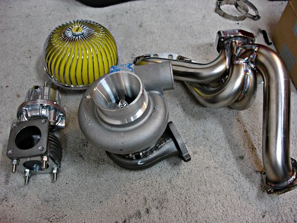

Finally steped up to the plate, Trust Bits
:thumbs:
P
Paul2x

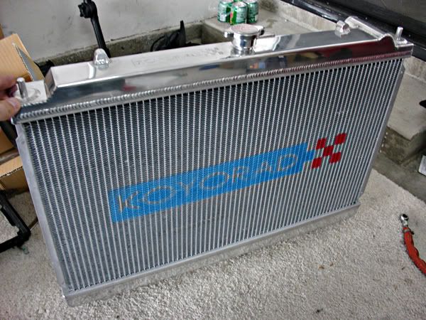

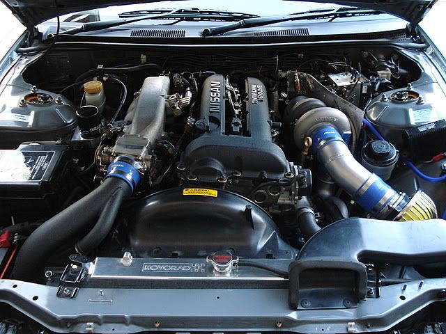

Water Cooling, Koyo :D
Oil Cooling:Setrab 25row, with Remote filter
P
Paul2x
The goods' :D (version 2)
More to come, stay tuned
:thumbs:
