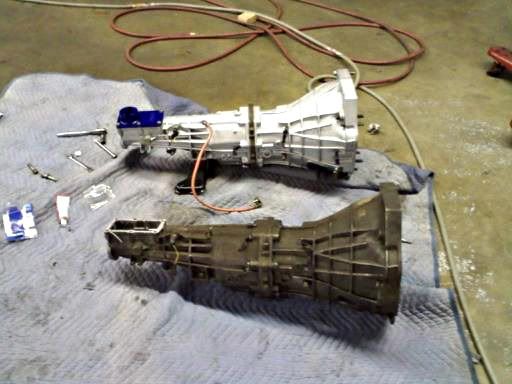

Did a complete overhaul on the PPG Dog Box, threw a spare stock 5 speed in their while I was doing the overhaul on the other box. After a half season gears looked brand new. Refreshed with all new berings,

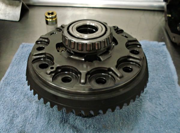

Nismo 4.63 Ring and Pinion:
Perfect match for the ratio's in the PPG box. Really wakes the car up.

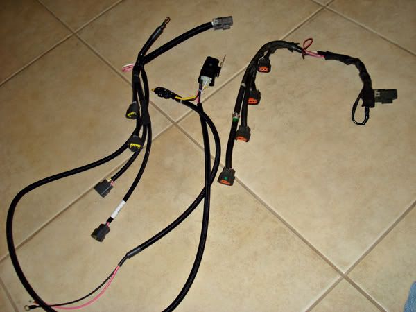

Yashio Factory Tenka Igniton Harness: (Yashio on the left, Standard on the right):

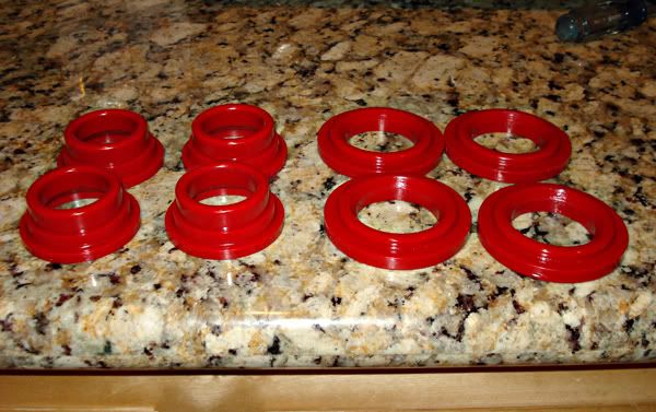

Peak Performance Sub-frame collars:
Also replaced all sub-frame bushings with Nismo units

paul whats the story behind the yashio ignition harness? What gains can you expect from it if you get me?
Well when you see it in person it's much beefier than the OE unit, and also has a relay that is attached directly to the battery to pull extra amps when needed. I was having some mis-fire issues when I started to run some real boost, and it turns out that 15's are notorious for this problem due to the coil packs. In my research I found that several of the "hard core" 15's out their usually end up running some other sort of ignition set-up, like switching to S14 ECU and coilpacks. Since Yashio Factory has several S15 customers they found it easier to come up with their own solution in this harness.
I didn't do a before and after dyno but, with my mis-fire issue it made a drastic improvement.
I'm headed back to the dyno so maybe i'll do a test on it, but it's evident it's an improvement over the stock unit.

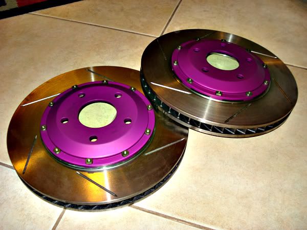

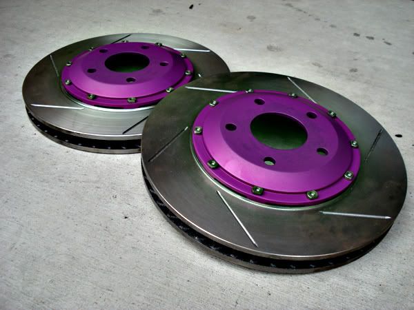

Just arrived: :cool:
Biot 2-piece GTR rotors
Install pic's coming soon.
Spec's on Page 1 updated =)

very nice split discs... i regret not gettiing split one for my conersion, i used pmu scr slit disc, but they are just soo heavy.
cant wait to see completed conversion
P
Paul2x
They sould be lighter. These are almost 4.5lbs lighter / rotor then the standard GTR rotors.
-9lbs of rotating weight +purple hats = :thumbs: & :cool:
