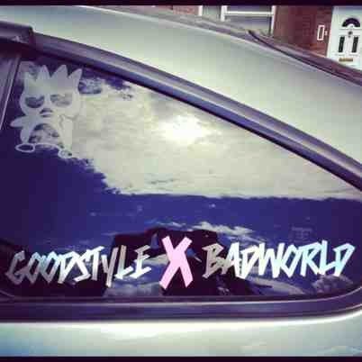

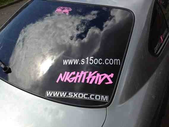

Awesome new stickies dude!! :thumbs:
I'm sure I've seen this NightKids group recently... think it was one Facebook??
4,640
Cheers dude!!Yeah bro is a group of guys get together for photoshoot around the London area all JdM ! Their stickers are normally white but I wanted to do something different ,think it looks pretty cool....

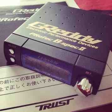

did you fit yours yourself?? Is it an easy job??
I didn't mate but it's very easy... One vac/boost hose off the intercooler boost pipework to the solenoid and one from the solenoid to the actuator or just fit it in place of the standard solenoid. Then pick up a boost source on the intake (fpr for example) and run it through to the cabin to the back of the unit. Pick up ign live for the controller and feed the other plug from the controller to the solenoid, set up then smile :)
4,640
Sounds pretty simple really will have a proper read through the manual and give it a shot this weekend I think.
Need to read up on boost setting / gain etc before I install it
Thanks again dude
