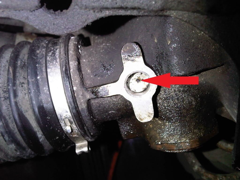

Hi guys, help needed here:
As you can see, the red arrow points the place, where steering fluid leaks from the system. Please let me know if something is missing from this part (don't know its name), or do I need a new part. Or lets say I do it the polish way - put a bolt inside this hole to stop this leak.

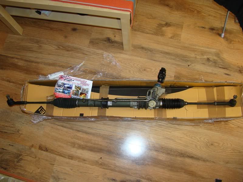

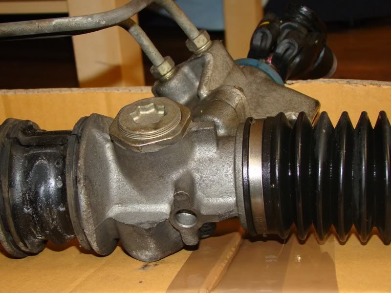

Just spoken to a mechanic and beeing told that putting a screw to stop the leak can help for a while, but inside seals and washers can be worn out, so next question: can I replace s15 steering rack with s14 one? Are they the same?
Regards.
I swear some of my posts have disappeared from here? Your new rack looks good mate, hopefully it will be simple to fit :)

steering swapped. works like a dream... Love it again, after one week my hands were sore, but now its back to normal. I will leave this broken rack and get it reconditioned, I have a full TEIN setup on it, so will swap that tomorrow, before I go to alingnment.
Thanks for help.
