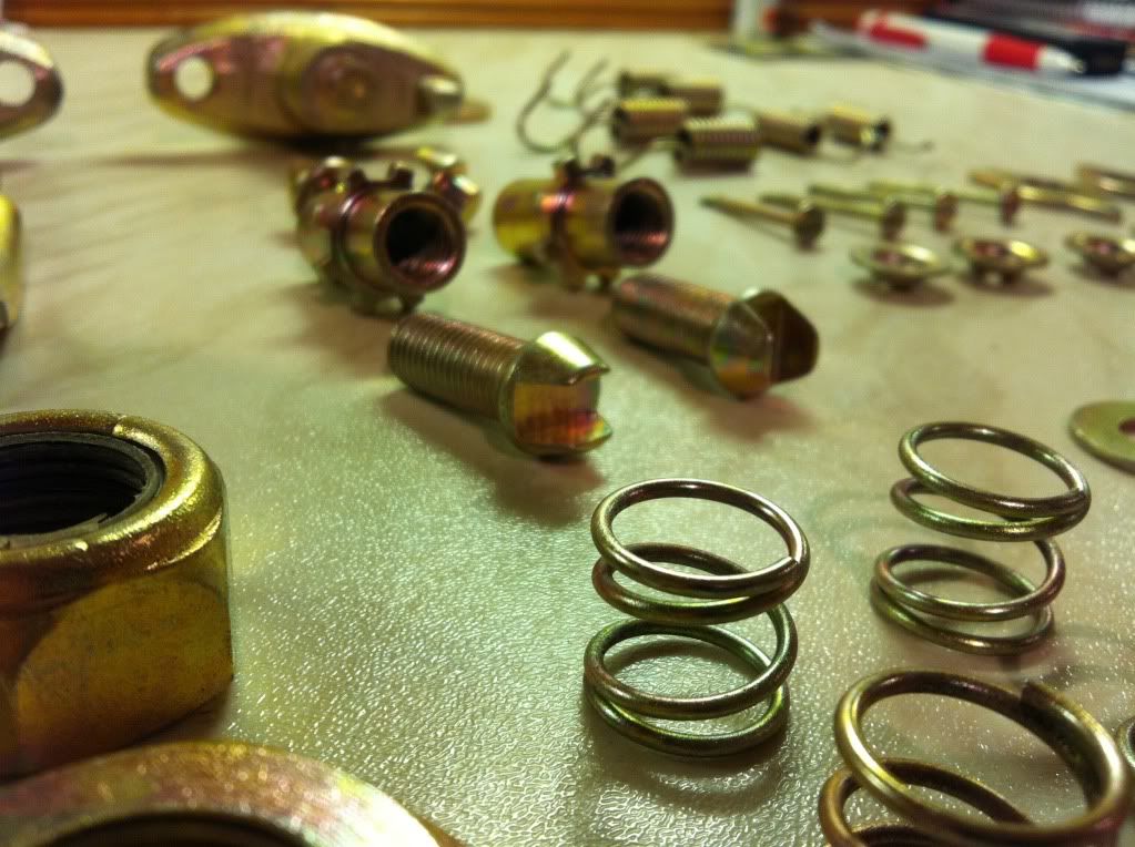

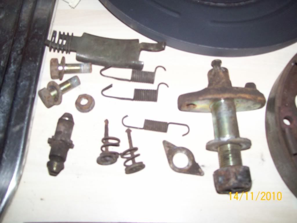

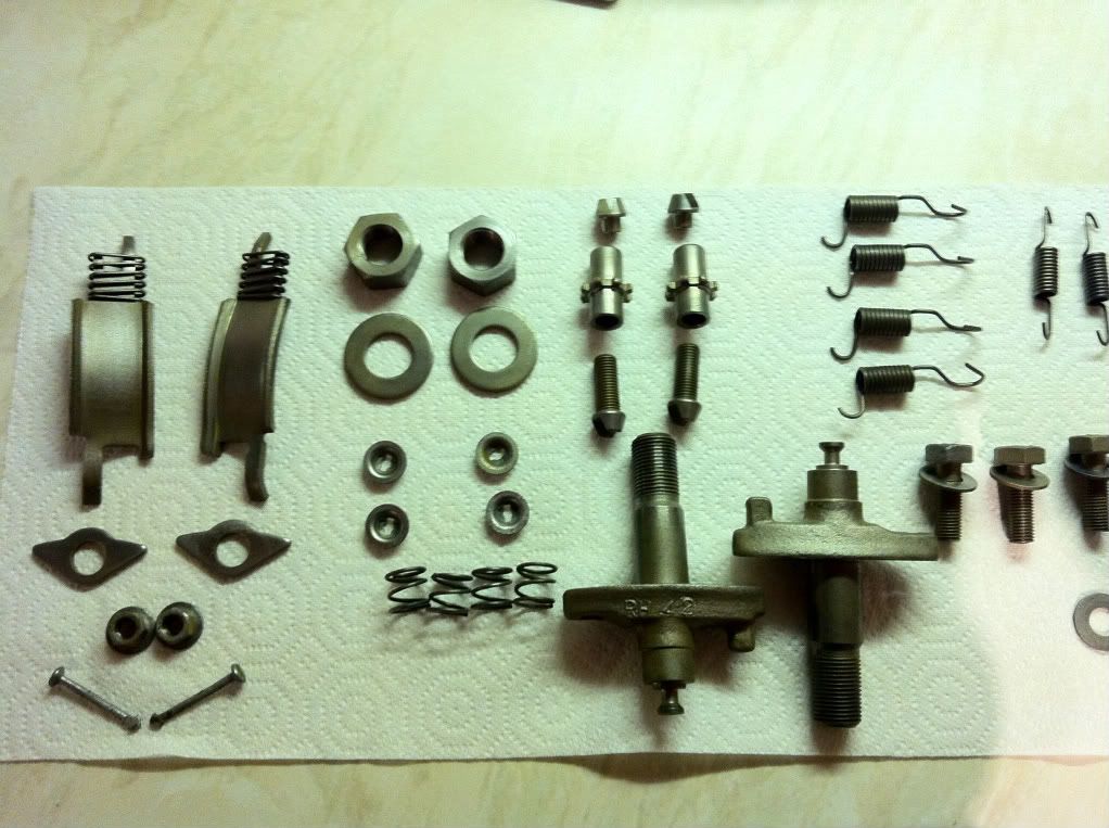

Here's a pic of most of the handbrake parts after I had stripped them in Deox-C (15:1 solution)..

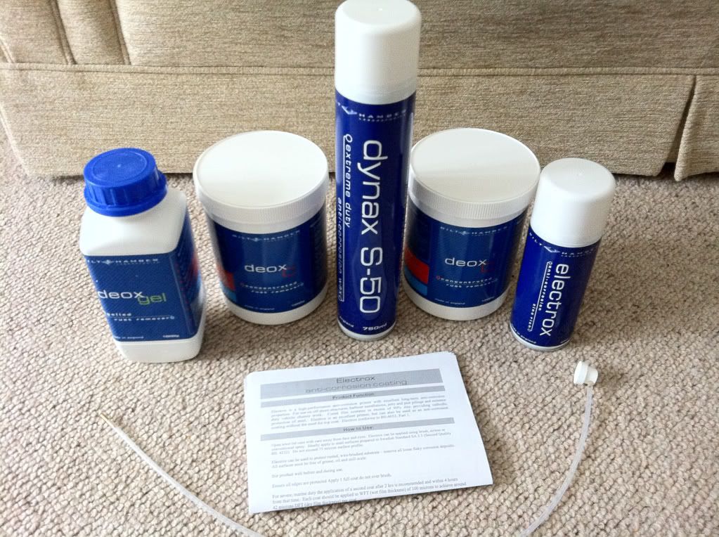

And some of the stuff I'll be using over the next few weeks. I've also bought some 3M underseal too and a spray gun to apply it with, so once the suspension is all removed from the arches, I'll give them a good coat along with any other areas that would benefit from it.

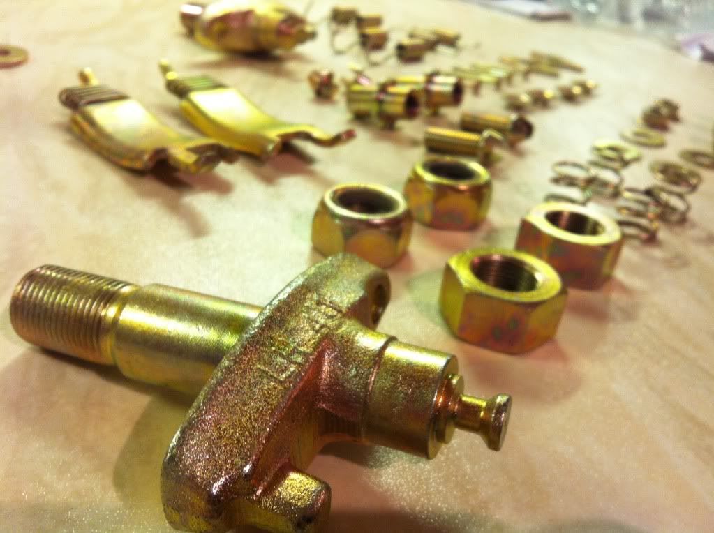

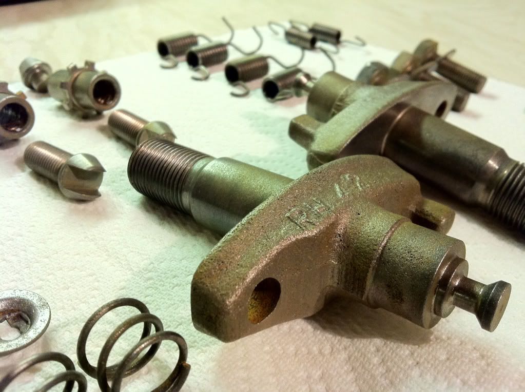

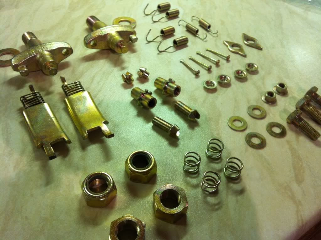

I picked the Z32 handbrake parts up from the platers today. Here's a before and after picture to show the difference. I'm really happy with the results, better than I ever expected and all for £10.00. And they didnt loose anything at all!!
BEFORE
AFTER
They sure did. I stripped the parts before I took them to make it easier and hopefully better results.
The owner of the plating company was showing me around too and explaining the process. I mentioned that I thought about buying a kit to avoid lost parts and he basically said they often get people in after attemping to DIY it! The process they've adapted means it's almost impossible to loose any parts too.

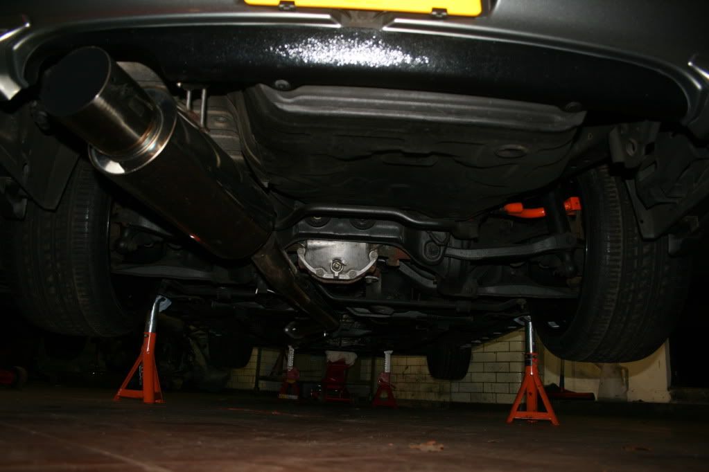

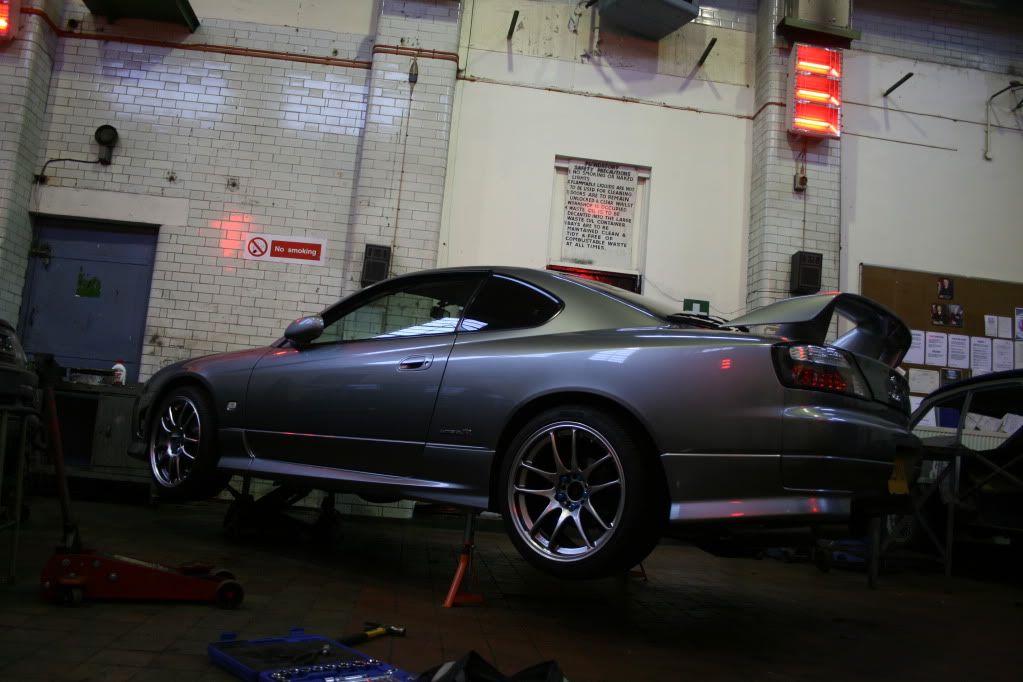

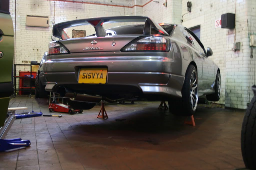

I made a good start on removing the subframe today. The first job of course is to get it nice and high in the air. I'm doing all of the work on the deck as I think the majority of it will be easier this way due to the weight of certain components.
I decided to copy Deans idea and make wooden supports for the axle stands so they can be placed under the sills without damaging them. I supported the front from where the wishbone mounts to the front subframe. I'm dead paranoid about it falling so I've also left a jack under the front subframe and the diff at the rear for now. This should give me ample room to work under the car too.

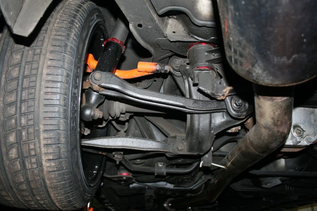

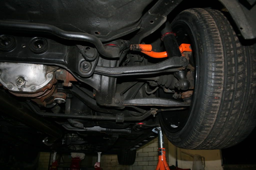

Once it was all raised up I began to remove everything attached to the subframe and undo the hub nuts. Everything is now disconected incl. exhaust, brake lines, handbrake cable, brake callipers, diff sensor cable and prop shaft (fully removed). So tomorrow I just need to remove the rest of the handbrake cables from the subframe and she should be ready to drop! And, I only smashed my finger with the hammer once! :wack:

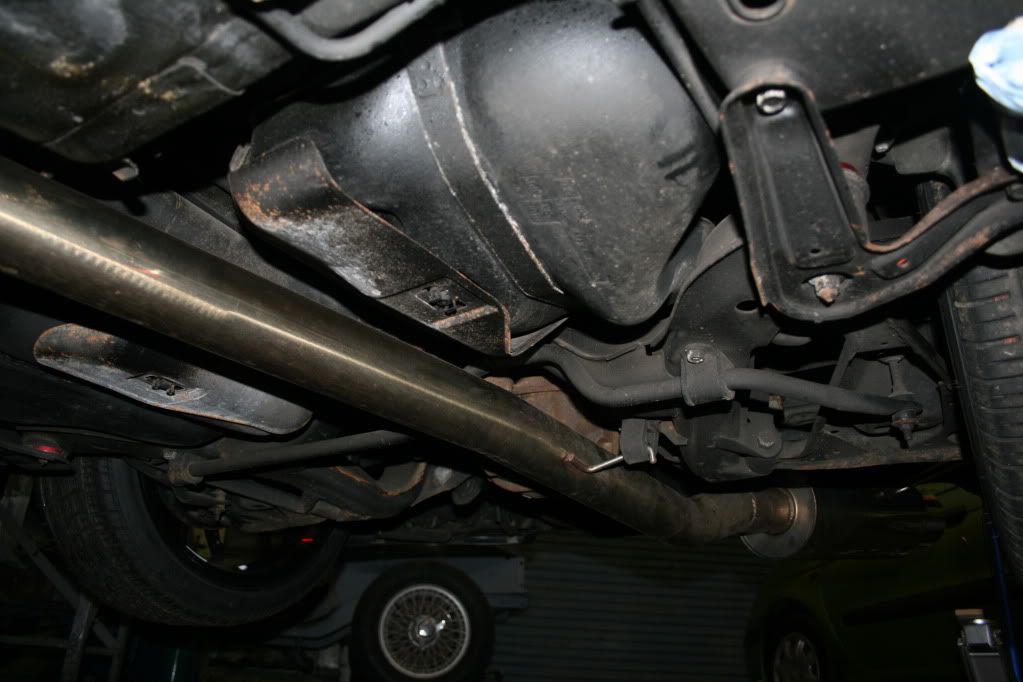

After having a good look underneath I was really pleased at how little corrosion there actually is. The car was treated when it was imported into the UK. This underseal doesn't look amazing, but it certainly has done it's job well. I'll be removing some of it and giving it a fresh coat along with the chassis box sections. too Not that it needs it because it won't be seeing crap weather after all of this time/effort. :p
looking good mate, lots of workspace you have there - lucky sod lol. the wooden blocks wasn't my idea mate, i copied it from petrol on sxoc :)
Yeah, theres plenty of room there. You may have also noticed the massive infa red heaters!! Haha! ;) :p
bastard...........hahahaha it's the best and worst time of the year to be doing this without heat lol
