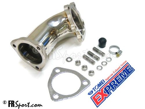

TOMEI Expreme Turbo Elbow from FRSPORT.

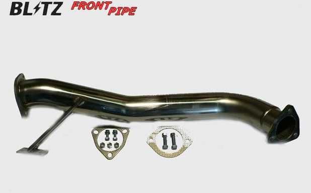

So i managed to find a Blitz downpipe from Amber Performance in the UK, for a more reasonable price.

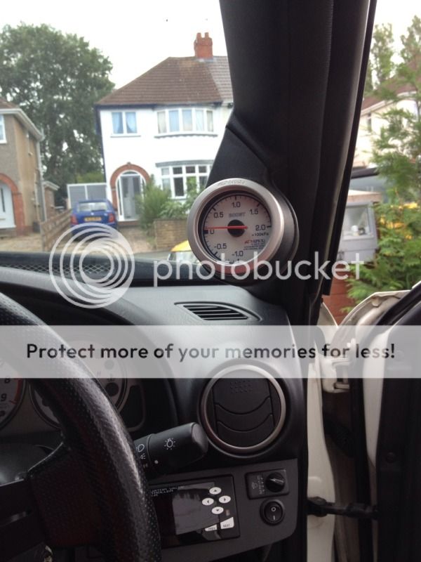

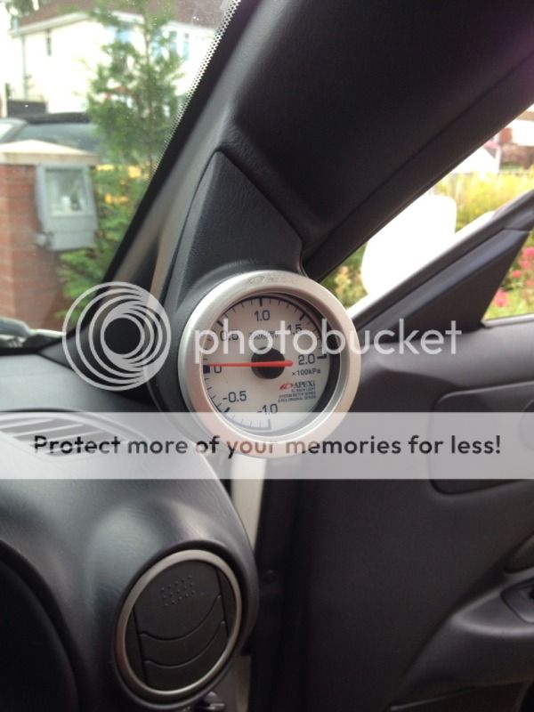

And i replaced the faulty OEM boost gauge with an Apexi unit, to match my list of Apexi bits in the interior,
To fit it in the oem position i had to cut the surround out slightly bigger, which i did with a dremel with a diamond cutting bit.
just have to wire it in on my next day off.

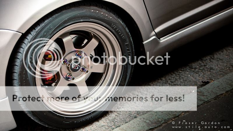

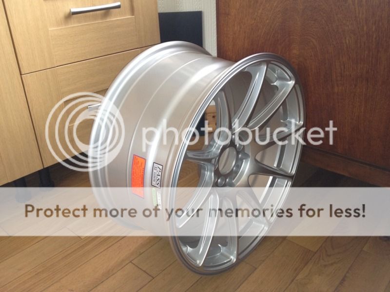

Also bought a pair of 18x8.75 527's et35 for the front, to replace the 18x9.75 et20's. this will give me more clearence to go lower, without the tyres scrubbing. plus, i think the staggered setup should look quite good.

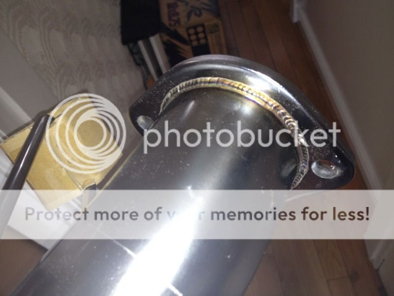

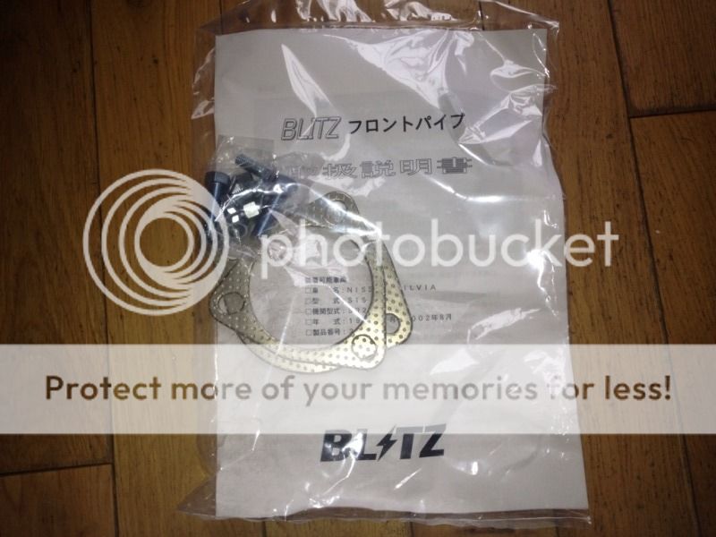

Blitz front pipe turned up today
Quality is as you would expect from Blitz

Hey mate, very nice car and I love the wheels. I'm looking at getting the same for mine , did you have any issues with inner clearence on the front? I'm worried about hitting my coilovers.
18 September 2011
726
West Midlands, England
lovely car mate and good man for importing a s15 to this country, any chance of you selling the nissan gear nob and if not then were the hell do you buy the original ones from, ive looked everywere with no luck and iam desperat for a clean original one
you would be suprised how many people have asked me for that, but unfortunately when it arrived at Liverpool docks it was missing. some light-fingered Japanese dock worker i'd imagine!
Yes mate you will need to space them out, i have used 5mm spacers and rolled the arches. they catch the inside of the wings on hard bumps in the road. Coilovers such as Driftworks CS2's which are designed with slimmer springs, will maximise wheel clearance so it depends what suspension you go for really.

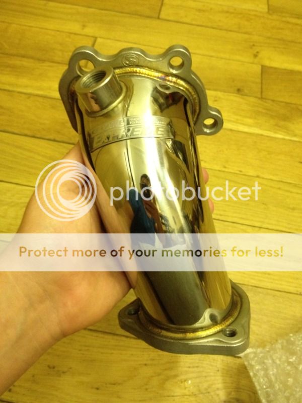

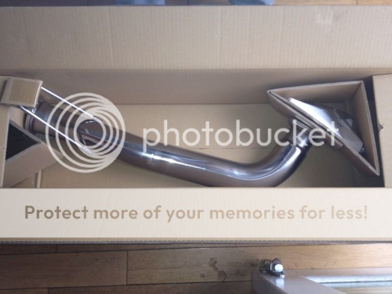

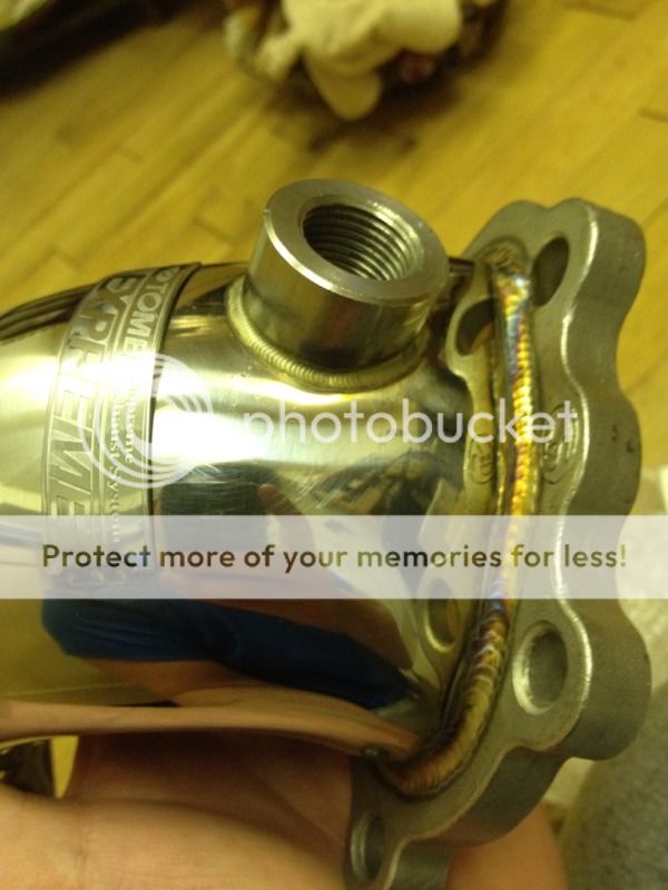

Tomei Elbow has arrived -
The quality is just amazing, as you would expect.

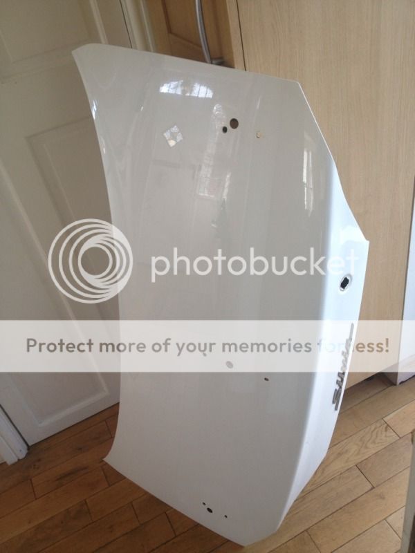

i also collected a second boot from Shane, to install the oem spoiler onto, which i bought when the s15 was still on the water, on its journey from Japan!, as of course i don't want to ruin a perfectly good smooth boot.
not 100% sure whether it will be a permanent change, so will be keeping the smooth boot until i decide either way.

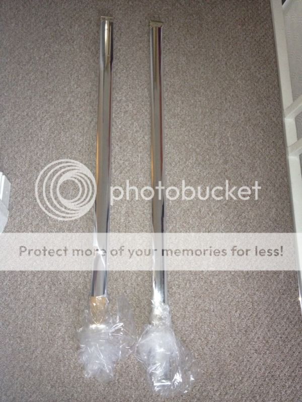

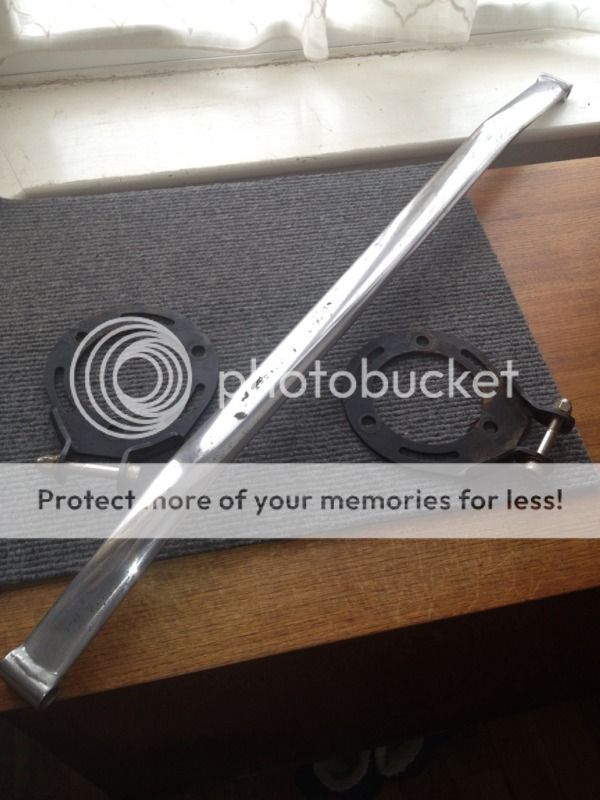

I had bought a front upper and rear upper strut brace a while back, and i have begun to refurb them ready to fit.
first step to split the mounts from the Brace
i then had them highly polished
and i'm now in the process of refurbing the mounts

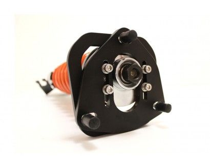

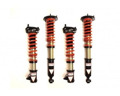

DRIFTWORKS CS2's!!!!
These being the latest revision of the CS2's, now coming with Front Roller Bearing Spring Seats, Camber AND Castor adjustable top mounts, allowing you to dial in desired castor at the top of the strut, whilst keeping the wheel centered in the arch and reducing LCA bind.
can't wait to fit them next week!!!!

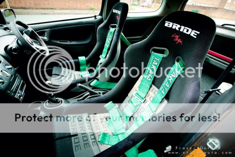

Picking up a new daily on Monday, which i MAY nab some parts off for the S15. these being one to mention
better use in the toy than the daily after all :thumbs:

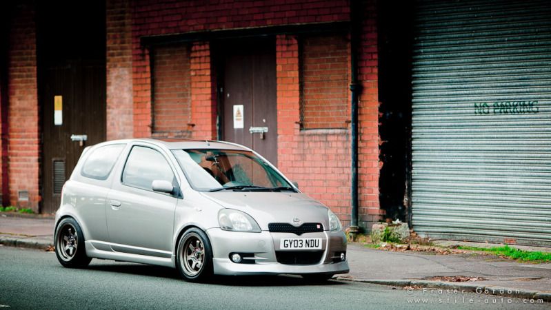

It's a bit of a downgrade from my current Audi A3 2.0TDI daily, but it will be quite a fun little car.
It's a Yaris T-Sport, 1500cc, pretty well spec'd and weighing around 900kg as it stands now.

nice bits going into your build dude, tomei elbow is top notch have one myself defo worth the extra money IMO

I love that Tomei elbow, the welds are just amazing, and it even makes you look good.... lol
18 September 2011
726
Yes definitely worth the extra cash, with them being such a nightmare to change you don't want to buy a cheap one that will crack. Changing it once is more than enough haha.
