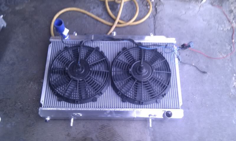

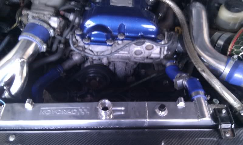

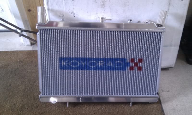

I got my new Koyo N flow rad a couple of weeks back and fitted it with a brand new Nissan thermostat

The rad looks very nice Adam :)

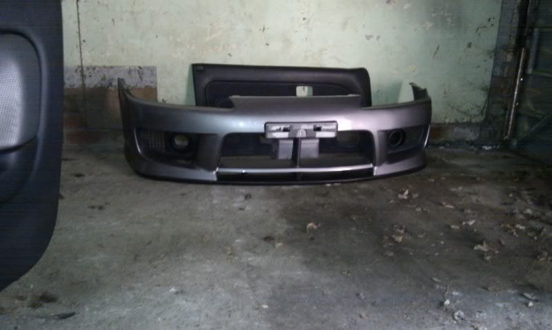

I've got back this evening from driving well over 300 miles. I've got myself an Aero front bumper after being after one for bloody ages, I just need the skirts now.

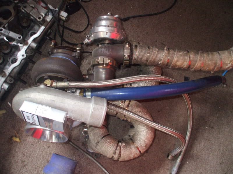

I also picked this up...

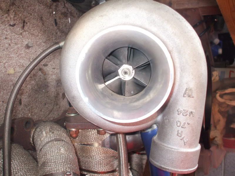

The turbo is stupidly large, I actually laughed when I saw the size of the compressor wheel. Full Race manifold too, I've got everything to make it a bolt on item except the instant mapping.

I saw this one for sale (don't remember where) couple days ago and thought "that's some badass s**t there" ...It' s going to be a monster S15...

I met Mark, Fasthands yesterday too, had a good old chat aswell, top bloke aswell for remembering I wanted his Aero bumper if he parted with it, well chuffed with it
