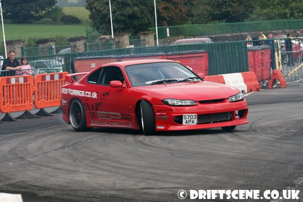

I've got 18X8.5 ET25 Front and 18X9.5 ET35 rear Ultralite Nurburgrings, which all fit flush though the fronts have a 5mm spacer. I have 4 rears so tried to fit them all round, but I reckon I'd need something like 20mm spacers to get them to fit past the front coilovers, then I'd have to fit my wide arches to accomodate them.
Does anyone know of any 17X9's that look similar, so I can possibly fit them to the front and use the 18's as rears?
Cheers to Victoria Russell for the pic.
