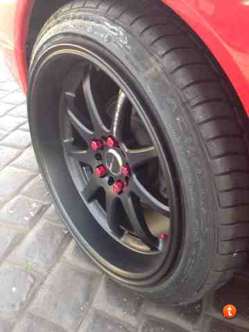

. My wheel is sticking out to much past my tyre what can I do to fix this?
cool wheels
id say when you lower your car that will camber in, you might need to roll the lip out of the arch
Yeah, you're going to need to roll the back (No real need for a pull), and get the camber adjusted. You might as well run it like that till you get your suspension sorted (coilovers and arms).

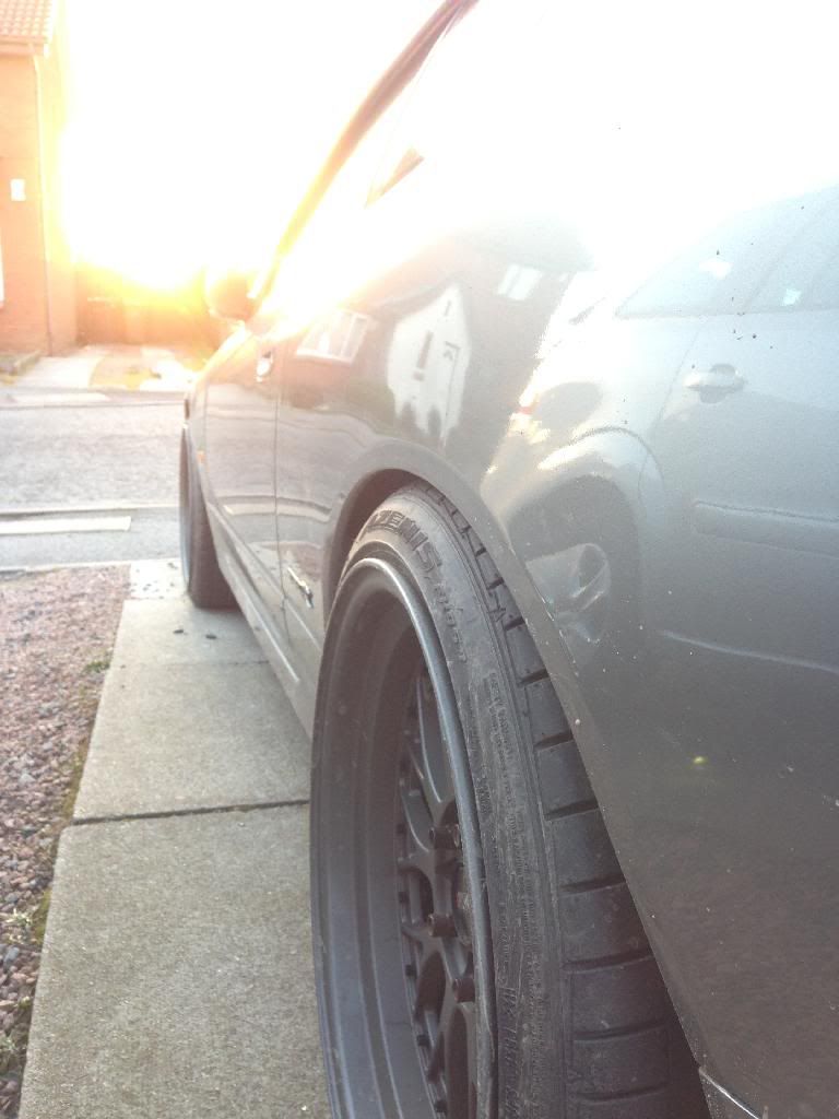

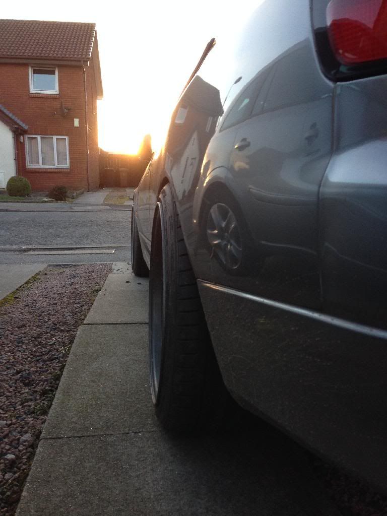

Sorry they're a bit dirty.
These are 18" x 10" et20 with 245/35/18 tyre.
I have managed to fit them by just a little bit of arch rolling and only 2 (ish) degrees of negative camber, so very little really.
