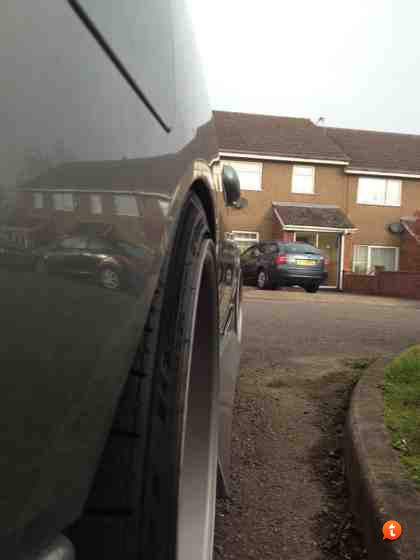

I run 18x10 et38 on the rear with 255/35 and that fits fine. Not too sure they would fit being another 16 mm further out like yours will be though, mine fit nicely to the arch maybe about 5mm . You may end up having to go for the 245 mate, hard to tell really till you try it
Tried to get a decent pic for you so you can get a rough idea ,my arches are flat back

Good stuff, thanks dude. I've gone for a pair of part worn vredestein sessantas in 245/40, that way if it looks like I will be able to get a 255 on, I won't have spent loads on new tyres only to find I can't use them and will be able to buy a perfect set next time if that makes sense. Pretty sure all manufacturers sizes are slightly different as well which makes buying tyres really easy (sarcasm).

Good idea bud!
Yeah they are all totally different mate! I am running kumho ku39 atm and they have a decent bit of stretch so good clearance, prior to that I have run falken 452/453 , Pirelli p zero michelin ps2 to name a few ,some rubbed some were fine , all down the sidewall profile ! Some have rim protectors, thick walls all sorts ha ha Proper pita and something you wouldn't normally think bout when buying tyres ha ha good luck with it anyway mate ,sure you won't have much trouble getting them on. Look forwarded some pics when they are on :D
