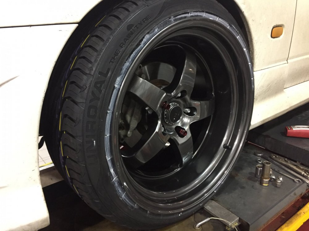

little update, Ive just purchased some new wheels, I absolutely love how it sits on them! they are japan racing jr12s
9j all round et25 all round (20mm spacer on front so technically et5 on the front)
215/35/18 tyres all round, arches are not rolled.

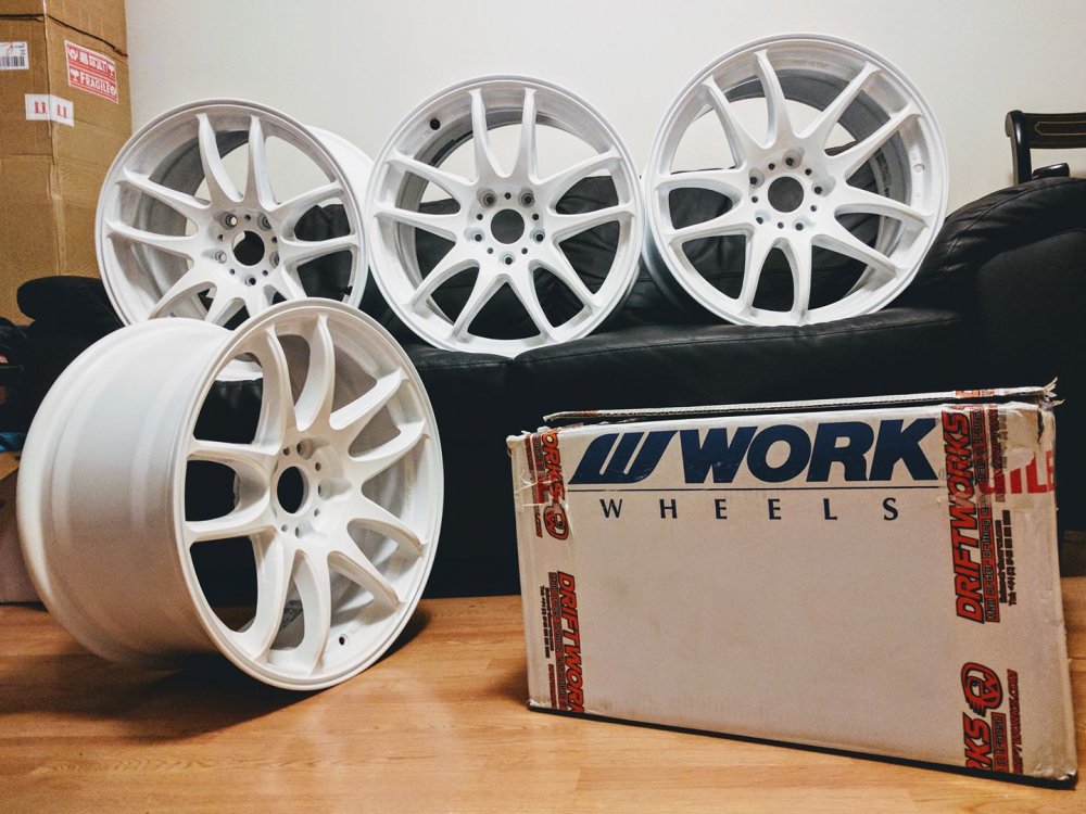

Gonna be ordering some wheels soon, just need to check if the sizes I'm ordering will be ok?
18x8.5 +32 front
18x9.5 +38 rear
The wheels are Work D9Rs btw
Thanks in advance

Rears are good...maybe fronts would be better between +28 to +30 with that width

Lowest offset is +32, I'll put a spacer in if needs be, how about tyre sizes? Was thinking of going 225/40 in the front and 235/40 in the rear? Car will be lowered about 10-25mm from stock height.

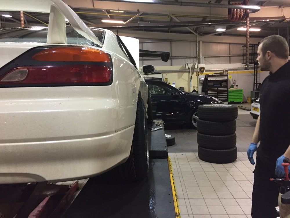

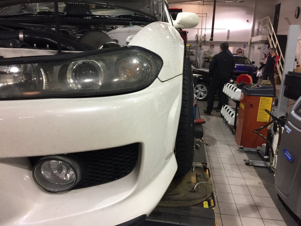

Wheels: 7Twenty Style 49
Size: 18" all round
Offset: ET 18 all round
Tyres: 225/40 R 18 - Stretch is a bit crazy but any wider tyres and arch work/more camber required
Spacers: Front Hub centric 20mm spacer for caliper clearance giving the front an effective offset of -2, Rear 5mm slip on spacer effective offset 13
Suspension: Driftworks CS2 coilovers, camber on the front (not fully setup yet will update when i get it into my work to set it up properly)
Comments Wheels do stick out a fair bit at the front so camber definitely required, could do with pulling arches out at the front and rear.

Cheers guys, gonna order the tyres next month, 225/40 in the front and 255/35 for the rears.
